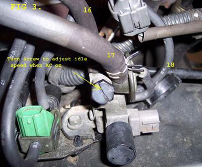

THere is a little idle up adjuster on teh intake. Have you seen that? Maybe you just need ot adjust that? Sorry if you already knew that.

It looks like this: https://www.yotatech.com/attachment....achmentid=9115

Thanks. I did not think to look at that (after all these years). Stupid question--are you referring to a EFI (22re)? I do have a 22r (carb). And, it is an automatic.
