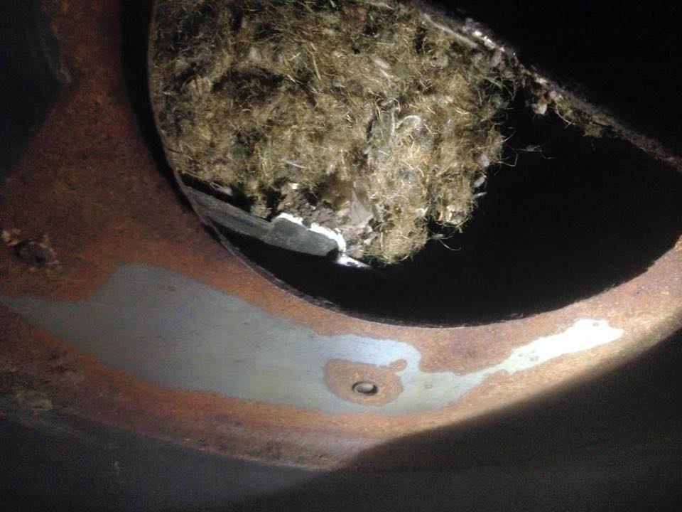

Working on getting the 4Runner back on the road

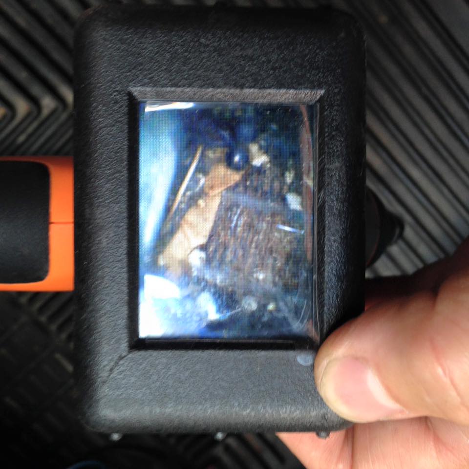

Cleaned out the mouse nest in the blower
Next - use a see snake to see - yup - I need to pull the evaporator to clean off the muck thats jamming it up

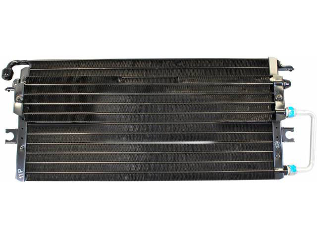

Then - I was reading an other thread about going to a "parallel flow" condenser, and looking to see what might fit (12"x21" or so)
But while looking at the 4Runner, it looks like there are TWO condensers in there - a 12"x21" in back and a short 4"x21" one in "front"...
Then I found a replacement part picture and yup - there is a second condenser....
Pic of OEM condenser borrowed from a website..
http://www.partsgeek.com/assets/dima...27-1174587.jpg
Still - if the claims of parallel flow condensers are to be believed, then I could replace the OEM condenser with a parallel flow one without the extra front condensor.
