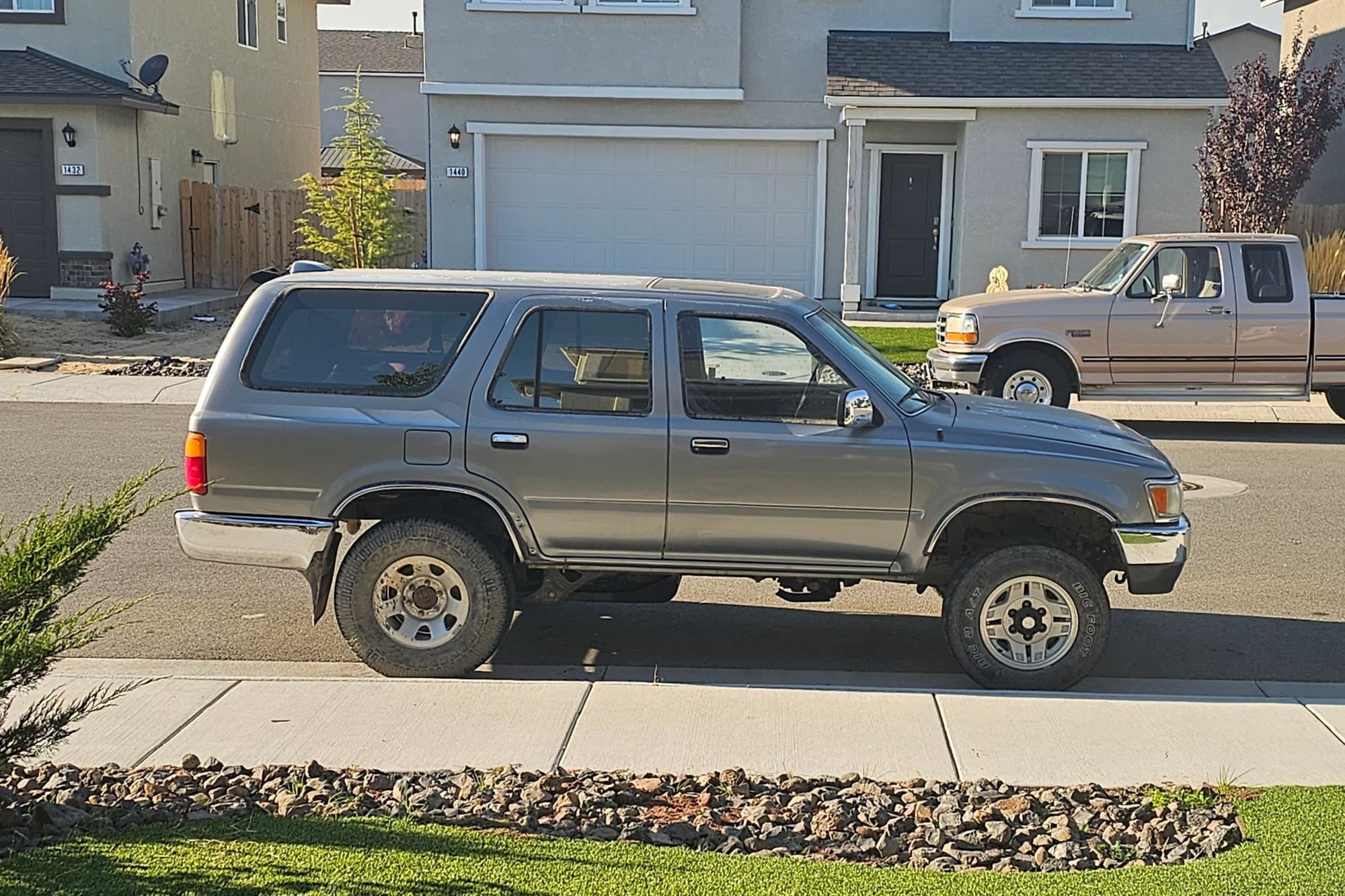

I have a 1993 3.0L 4x4 4Runner. I purchased it back in March. It ran but had some timing issues, a bad water pump, and a few other things, only related to the motor. Took it to my local Toyota dealership to have the work done on it because I couldn't do anything at my apartment at the time. Fast forward a month, my truck is finally done, but I get a call after the final test drive stating that my transmission blew and had to be towed back to the dealership. I got it towed home because they pretty much told me theres nothing they can do to fix it. It was still driving short distances but only until it reached operating temp. Once it reached temp, it would slip out of gear and would not move until cooled down. Today, after not moving it for maybe 3 months, I went to move it and it slipped out of gear after about 100 yards. Now I don't have any engagement in the transmission whatsoever and it does not move at all, even if it's cold, which wasn't an issue before. At first I assumed it was the torque converter but now I'm not sure. Is it looking like I need a rebuild? Anyone else have a similar problem before?

it looks like the front and rear tires are a different size. This is bad on most 4wd/awd vehicles. You don’t want the front axle spinning at a different speed then the rear.
It's just the one tire. All 4 were the same size until someone took a knife to the front passenger. Spare tIre was smaller than the rest. The guy I bought it from put 4 different tires on it. 1 is an MT. 2 are AT. The last one is a street tire lol. I just haven't had the money to throw new tires on it if it's not gonna be drivable
