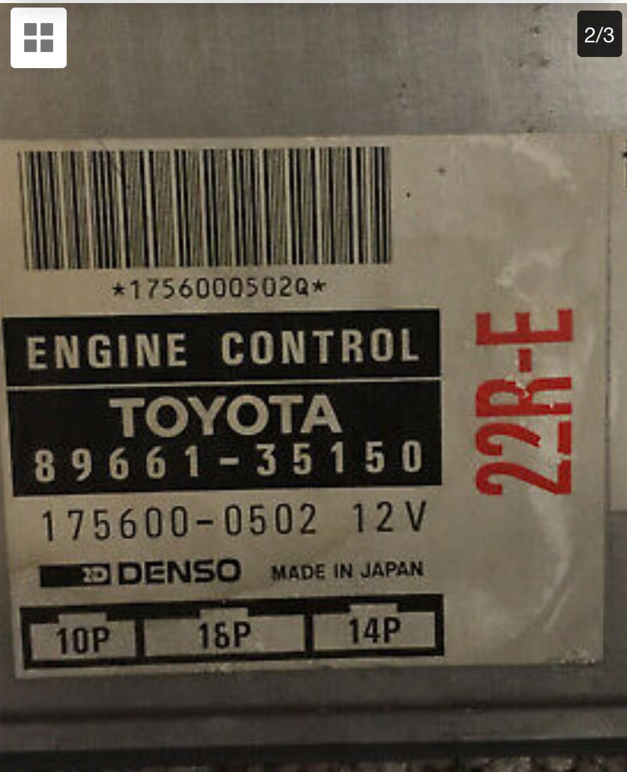

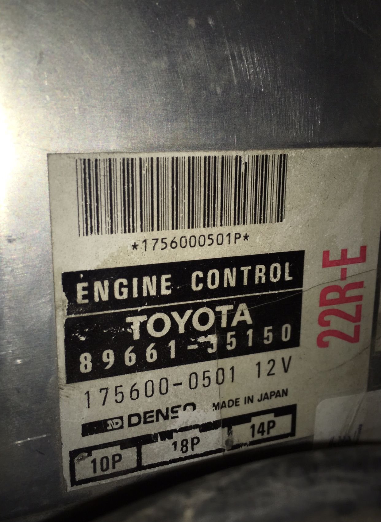

My check engine light is constantly on. Took it to the shop and they said that they hooked it up to do a diagnostic and it kept throwing inconsistent results. They said that it has got to be the ECU. Second opinion said ECU and/or mass flow sensor. I figured I’d start with the ECU first, since that’s the easiest to replace. Heee is a picture of my ECU and the one I found on eBay. The second PIN number is slightly off and wasn’t sure if it was compatible.
eBay ECU
ECU out of my truck

Both the ECUs have the same part number so they should be the same.
I think what we are seeing for the eBay ECU second connector is that part of the label is rubbed off on the 8 making it look like a 6.
The second connector should have 18 pins for both yours and the eBay ECUs.

1. I think old87yota is correct about the number of pins. (while not conclusive, note how the 6's elsewhere on the ECU have a sloped top.)
