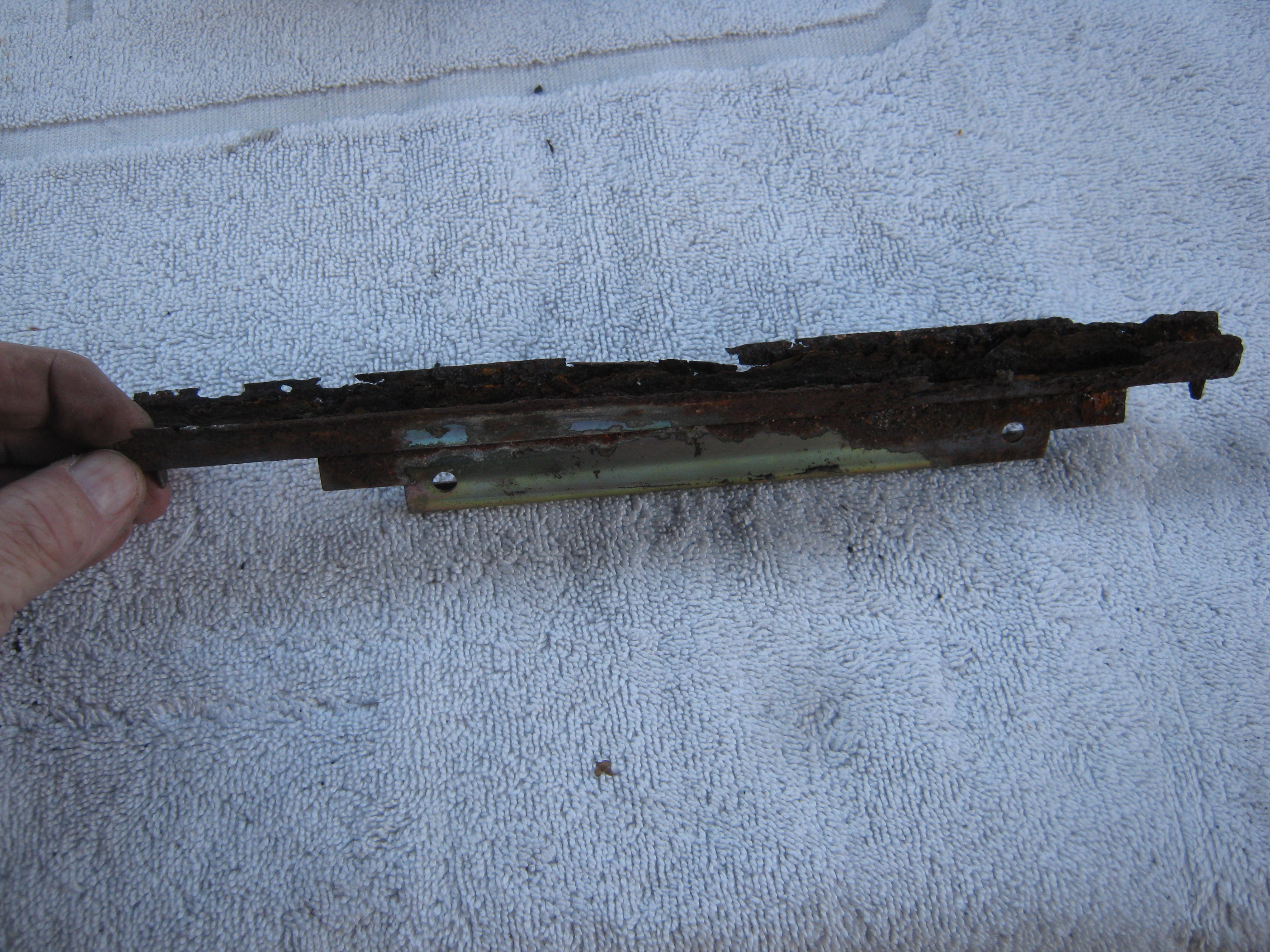

While lowering my tail gate window from the driver seat, I heard a clunk, and observed the glass go catty wampus and suddenly do a jam stop, passenger side down.
Took tail door apart, and found the pass. side glass riser laying in the bottom of the door. It was rusted almost beyond recognition.
Driver side riser was fine showing only a very minimum of rust.

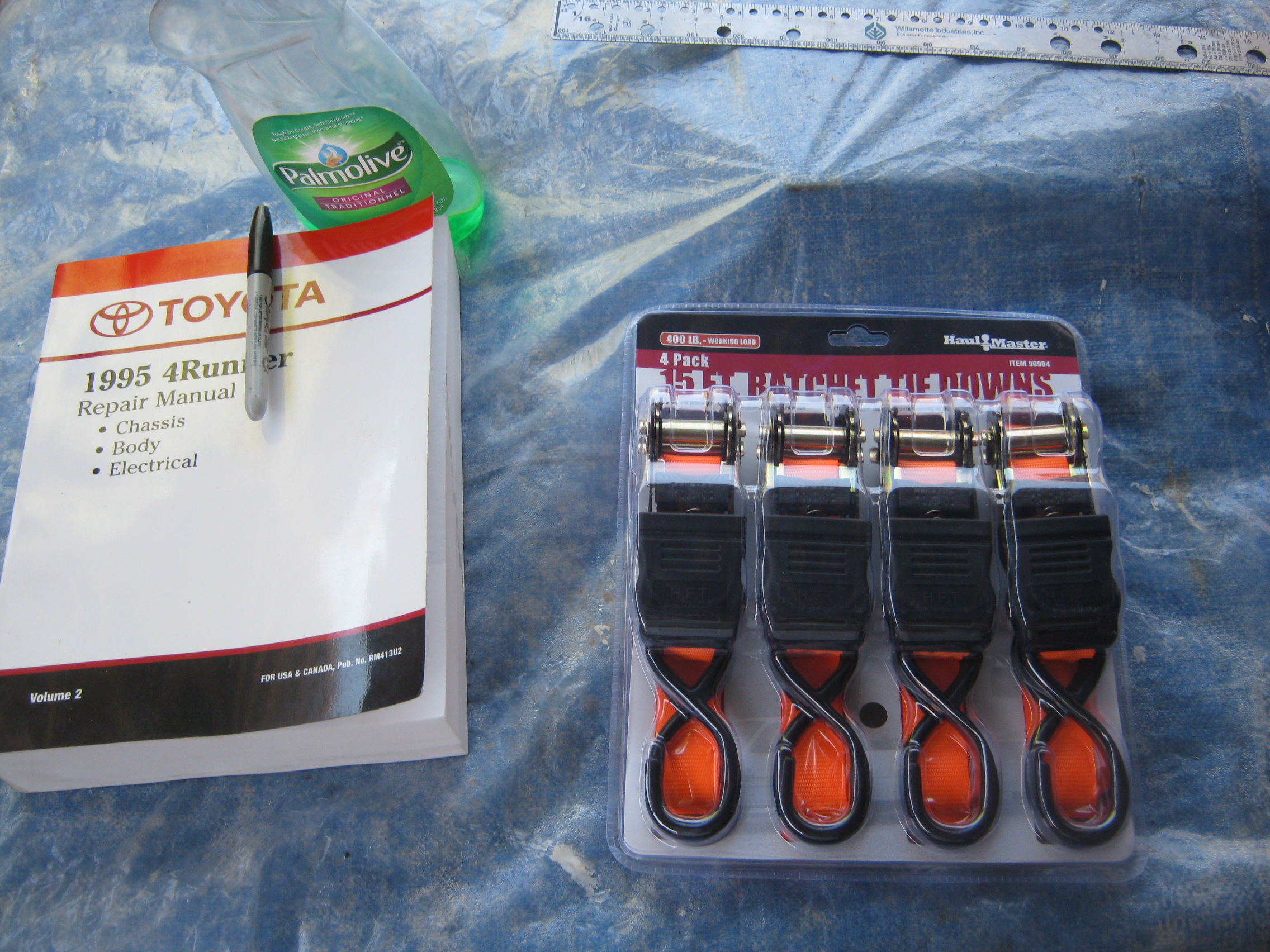

A set of 4 ratchet straps from Bejing Freight for 12 bux does the job.
The trick is to use a brace across the top of the glass where it curves so the rightmost strap doesn't slide off of the curve when you tighten the end ratchet.
In the picture, the two leftmost straps hold the brace tightly to the glass, and the two rightmost straps do the job of forcing the riser and filler securely on to the glass. Trying to attach the riser by beating the snot out of it plain just doesn't work. Too risky.

Attached Thumbnails 95 runner tail window blues-img_1539.jpg   95 runner tail window blues-img_1535.jpg   95 runner tail window blues-img_1537.jpg   95 runner tail window blues-img_1531.jpg
