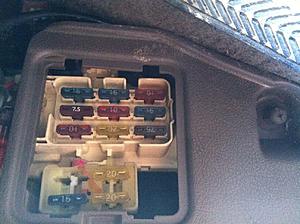

Fixed It!
If 7.5 ign fuse is blown, you will not get power to pin 1 of EFI relay.
RAD4Runner. You nailed it! Thanks. The 7.5 ign fuse was blown. I changed that, and it cranks right up with the old efi relay. I would have never thought another fuse was the issue. Electronic problems confuse me, and I never could figure out how to read those wiring charts. Thanks for the info!

The IGN fuse also drives the ALT light. You should now have the ALT light on with key-on, and off once the engine is running.

Originally Posted by eternalife77
RAD4Runner. You nailed it! Thanks. The 7.5 ign fuse was blown. !
Most welcome. Awesome! Did you see it blown, measured voltage, or continuity?
It's always good to have the schematic and a multi-meter when troubleshooting. Then trace the power path on paper to help you check each point in order... but yeah - even I find some schematics confusing, especially when they're not continuous on one page, and one needs to jump around from page to page.
BTW,
1) While you have time, it would be a good idea to check wiring, etc to see what caused IGN fuse to blow. Just to make sure it does not catch you again at a bad time or place.
2) Do you have the 3.0 or 22R-E? I highly-recommend putting model-year-engine-transmission-trim on your signature. It would help save everybody time in the future. BEst of luck with your truck maintenance/restore, AND MOST OF ALL FUN USE.
