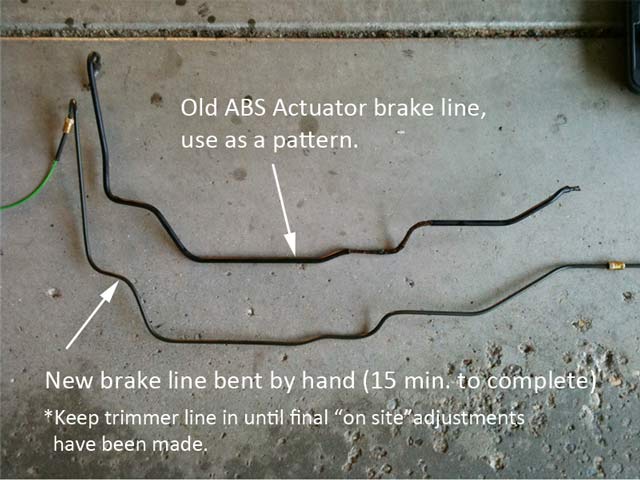

Had to replace most of my rusted brakes lines from the ABS actuator back to a recently installed replacement LSPV. This method works great for multiple radii and also making adjustments before connecting each line. The green weed wacker trimmer line can be purchased at any home store.
Attached Thumbnails 95 4R hand bent brake lines made easy-step-1-brake-line.jpg   95 4R hand bent brake lines made easy-step-2-brake-line.jpg   95 4R hand bent brake lines made easy-step-3-brake-line.jpg

Thank you! Yes, I am aware of the tube benders, didnt have one, didnt want to rent one, so out of necessity, rather laziness I decided to try this. I have a lot of experience working with bending large diameter steel tube/rod and a tube within a tube had always kept the outer tube from collapsing, with our without a tube bender.

3/16 O.D. brake line (which, wadda ya know, would be 4.72mm O.D.) has an I.D. of 0.118(inches). So your bends are going to "collapse" down to 0.080. That's not too much, but would you be better off using 0.095 trimmer line? Put another way, just how hard did you have to pull with pliers to get the 0.080 out of your pictured piece?

Thanks scope103! I had a roll of .080 for my weed wacker and used it to bend simple caliper hard lines. I havent had any issues with thoser lines so I stuck to what seemed to work well. Might be able to use larger trimmer line but the bent ABS line took a bit of pulling with pliers (just to get it started) only because I was used to pulling simple bends with my hands. I did have an "oh shoot" moment though! I would try a few pieces first.
