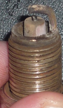

Several months ago I began to notice what I believe was a VERY intermittent misfire (as identified by a friend riding along with me). This RARELY happened, and as such was not much of a concern to me (bad?).
Anyways, about 2 weeks ago (+/-) while driving home from a 200 mile trip, in my last mile or so the intermittent misfire turned into misfires left and right.
This went on for a couple days where when I would start the car, it would make a good bit of noise, there was no power (acceleration was practically nonexistant), it was just terrible. Additionally, after the engine would warm up, if I let off the gas it would quickly drop down to between 450-500 rpm for a period of maybe 3-5 seconds, often times sputtering out after that. After making several concerned phone calls, I, based off of recommendation, replaced the spark plugs and ignition wires.
IMMEDIATELY the misfire problem was gone, for the most part the engine idle seems to be back to normal, and the engine no longer dies at idle after warm up. HOWEVER, there is virtually NO power!
When I pulled the old spark plugs (I was using Pulstar "pulse plugs" that I bought a year or two ago, which probably have MAYBE 30,000 miles on them and I'm sure that's a generous over-estimation), which seemed to have what looks like a rusty-ish deposit on the arms, I noticed that one of them basically just fell apart in my hand into two pieces. I figured it was the culprit.
What seems odd though, is that if it was just the spark plugs, I can't imagine that two different spark plugs could have THIS drastic of an effect!
Also, I'm about half-way through the gas tank as the gas gauge reads right now, and I'm only at like 100 miles, which is god awful compared to the 150+ miles that it's usually at when it reaches the 1/2 way mark.
Attached are pictures of the spark plugs in case that helps with the diagnosis.

FIRST: Read the sticky at the top of this section of the forum titled "Official 86-95 FAQ READ FIRST!"
1. Most common reason for low power is the pigtail that runs under the intake manifold from the Knock Sensor to the wiring harness. A break in it will render the timing to 0 degrees & power will DISAPPEAR.
2. Terrible mileage can usually be traced to an O2 sensor that needs replaced, but can be many other things as well. Miles of vacuum hose getting older & more brittle makes for a lot of possible vacuum leak potential.
3. Distributors wear out. Another possible reason for ignition problems & general bad power/fuel economy.
4. Ensuring GOOD connections on all the major power cables & GROUNDS is important to an engine that runs off an ECU. Check all sensor connections & specs as well.
Those will get you well on your way to finding your issues. There is literally NOTHING that hasn't been discovered & written about in the annals of this forum! Good luck!
...that would do it~

If you had a total deadmiss in the cylinder with the broken plug it's possible that you washed the cylinder walls of oil and now have incomplete combustion, even though the plug problem has been resolved. Pull the plug from the cylinder that had he broken one and see if it is all coated in raw gas or if it looks normal. Raw gas = problem to fix, no gas = good.
Also did you possibly cross a plug wire? That would cause a miss.
Do you have a CEL on? If so, the computer can tell you codes that will narrow down your problems.
Aside from havig no power, how does the ruck run othrwise? Will it rev up easily? Does it have a smooth idle? Does the exhaust smell normal or does it smell a lot like gas or rotten eggs or sweet?
You could have a totally unrelated problem to the spark plugs like a clogged fuel filter.
More info for us allows us to help you better

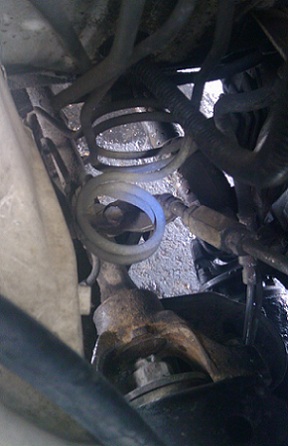

See attached picture. Do you mean these pigtails? They were the only ones that I could find under the intake manifold. From what I could see, they looked to be in fine shape, couldn't see any cracks or kinks of any kind.

You CANNOT "look" at a connection & tell it is secure. Oxidation under the nut, etc. can interfere with the connection. you need to remove the three major grounds (batt to body, body to frame, frame to engine) then clean thoroughly with a connection enhancer such as DeOxit, then tighten back down securely.
Use a propane or MAPP gas torch (UNLIT!!) & pass it around all the hoses (including the two that go to the front diff) & listen for idle uo to indicate a leak.
