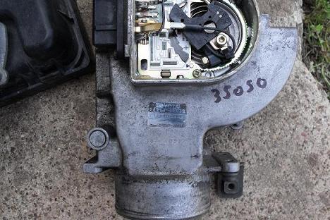

I put it all back together and went to start the truck and it runs for a about 2 or 3 seconds and then promptly dies. While it does run it runs clean, dosnt sputter or anything. Per the book I checked the vacumm hoses and made sure I didnt jar any wires loose. Here is where I found what I believe to be the problem. Earlier when I was removeing air intake and air box next to the MAS I remembered I unscrewed the wire harness that goes into the MAS thinking it was a plug. When I did so I broke loose some of the solder contacts on the MAS sensor board. (pic 2). Ok, lesson learned.
I went to the local junk yard and of course toyota pickups are hard to come by. I found a similar MAS from a early 90's 4 cylinder camery (pic3). Unfortunuatly when I hooked this up to the truck it didnt work. Even though the body is similar they do have different Denso / Toyota part numbers :

its a afm (air flow meter) the only interchangeable afm is 82 or 83 supra, cressida with a 5mge.

Thanks for the info, quick update to the thread:
I put the new air flow meter and truck works fine. (Does'nt die after the 3 seconds)
Expenisve lesson learned....
