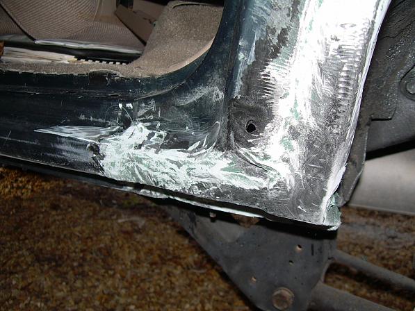

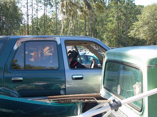

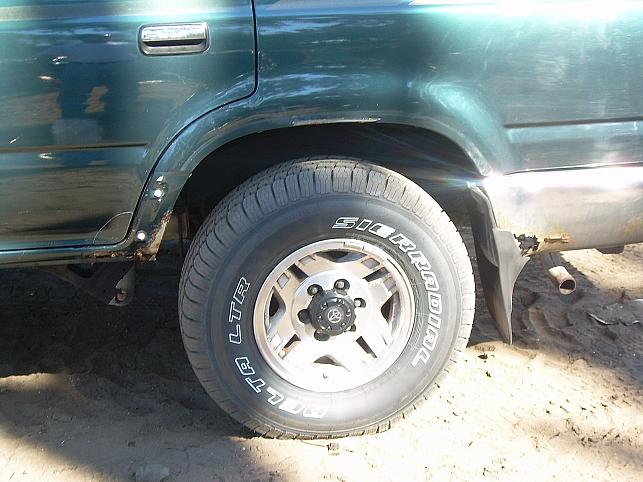

Here are some more pics of the areas that needed the most attention. That pic of the door in the back is the best shot I have of the door. It doesn't matter, because I replaced it with one from a bone yard. The pic on the far Right is the lower dog leg from the rear quarter pannel, where it meets the rocker. I had to cut both out on each side, pluss some of the rocker and the support panels underneeth. I welded the heavy underneeth panels, and I glued the thinner outer panels with #M body panel adhesive. Great stuff.
The pic on the far Left is the driver's side rear quarter. This side was in much better shape than the other side. I only had to cut 1/2 of it, and the cut was made below the area that is covered by molding! Much les body work. I was not as fortunate on teh passenger's side. I had to do a bit more body work.
