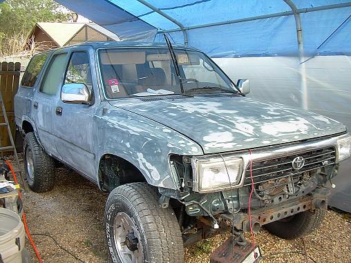

So far I have been working on this project every day for at least 8 hours, since last Friday. At this point, I am very close to the first coat of primer. The weather has been awesome, until this morning. It is 44 degrees and will warm up to about 70. I'm not complaining, it could be much worse, but I am working outside in a makeshift workshop made out of a portable carport and visqueen. I will add to this story for a bit, until the weather warms up.
The main objectives of this project were to:
1. Fix rust holes in rear wheel well arches.
2. Fix rust holes in roof (under rack).
3. Search for any other rusted areas and correct(without tearing the whole body apart).
4. Fix a few dings and dents
5. Fix some previous minor body work.
6. Change color from dark green to black, inside and out.
This sounded like about 40 hrs of work. So far I have dedicated at least 70 hrs of manual labor, not including planning time. I like to think things out well prior to starting. This can be a blessing or a curse!
This is what has been accomplished:
1. Welded new inner wheel wells on the rear(cut out bad sections then welded replacements).
2. Sprayed POR-15 inside rocker pannels and on all exposed metal.
3. Attached replacement rear wheel arches with body panel adhesive. Great stuff!
4. completed most of the associated body wdork with wheel arches.
5. Cut out roof rail rust spots and glued new replacement metal pieces from inside and completed the body work. I used dura glass for most of my body work, trying to use as little body filler as possible. I have also tried to seal all exposed parts with POR-15, adhesive, duraglass and will follow up with panel; caulk.
6. Completely sanded with DA sander, the whole exterrior. Most stone chips and scratches have been removed. I have always been under the impression of starting flat so you can end flat. i figureed if I spend more time sanding the old paint/primer, I will not have to sand as much of the new primer. We will see, but I am going to paint her black and it has to be perfect or it will look like S@#T!. I have masked much of the truck and will continue as soon as I can motivate myself.

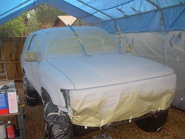

Pics, Finally!
Here are a few pics to help support my story. Once again, I got well into the project before I stopped to take quality before images. These three pics kind of sum up the three major stages. I have other pics that show the specific areas of concern. I hope you enjoy.

Status Update
The theme of this project has been "two steps forward, one step back". In spirit of this theme, I have a new story. I must warn you, the following story could either make you sick, make you laugh, make you think I am an idiot, make you feel bad for me, or just make you want to continue following up on my progress.
Just as a gambler only tells tales of big wins, most people keep their project screw-ups to themselves and only tell success stories. I am not like most, for I would rather have someone learn from one of my mistakes.
When I left off, I had been wet sanding and prepping for topcoat. I did finish sanding and did apply two coats of base and one coat of clear. I had worked all day on the prep work and had a timeline to follow, so against my better judgment, I decided to "pull the trigger". Using my Nason Base/Clear finishing products and my "starter" Smart HVLP gun, I completely wasted a bunch of time and money. I was in a hurry to beat the dark and I mixed the paint incorrectly. The ratio for Base is 8:1/2:4. I mixed up 8 parts of base, 1/2 parts of activator, and then instead of reducing it by 4 parts, I added 4 parts of the activator for the clear coat! Yes, this is the part where you can call me a dummy. Hell, why not, I did a bunch of times. My neighbor and I both read the instructions and both did not catch the mistake. Granted, neither of us has any paint mixing experience, but we can read, can't we?
Anyways, I sprayed two coats, and then put a coat of clear over top. It had a bunch of OP and I figured that I would have to wet sand and repaint, but I didn't realize that I had made such an error. The next day, I read the directions and realized my error. I placed an e-mail with Nason/DuPont tech support and finally received a phone call late that evening. That is when the bomb was dropped by the tech support guy. He told me that I had to sand all of the paint off and start over with a new coat of primer. Not only would I have to do this, but I would have to take lacquer thinner and get EVERY speck of product off of the truck or it would screw up my paint job. He explained that because there was so much activator in the product with nothing to activate, it would never fully cure and anything applied over top would eventually "melt off" once the sun heated it up. He said it would start with small bubbles, and then come off in sheets. To make matters worse, I had spent all day wet sanding the whole body in preparation for refinishing! Another day wasted!
I spent then entire evening with a rag and Lacquer thinner. My buddy who helped me screw up the paint mixing had a DA sander. Yesterday, I decided that the DA was working better so I used it to sand almost the entire body. I have to finish up the roof, and then follow up with every nook and cranny that the DA can't get. I will have to use lacquer thinner and a rag for this.
Like the pics show, I am doing this outside. I live in NE Florida, and despite what our northern readers believe, it gets cold here. It was 30 degrees this morning when I woke up at 5:30 am. It may get to 65 today, but the body will never heat up enough to help with the lacquer thinner. I may use a heat gun to heat the panels prior to wiping them. I may be able to get a heater, but I am essentially in a tent with visquene sides. It is a 12'x24' portable car port. Any wind would take whatever heat away quickly. If anyone has any suggestions about anything that may help my cause, please forward them on.
The tech support guy tells me exactly what DuPont wants him to say. He is recorded, so he can't give me the "real story". Do you think I would have to take every bit of black product off to ensure proper adhesion of the next coat?

Other notes:
1. When I applied all products, I was way too far away with my gun. Must be 6"-8" away from target when shooting.
2. More time must be spent wiping, blowing and tacking prior to application of sprayed products.
3. When watar sanding, use straight motions parallel with length of vehicle.
4. Must set up a system that allows me to get closer to the roof and hood without dragging hose across body.
5. Prior to aplication of topcoat, I must seal up my tent better. I may use a box fan as a negative pressure exhaust fan, positioned in one of the "gables" of the tent.
*If anyone disagrees with anything that I mention, please let me know. Constructive criticizm is welcome.
