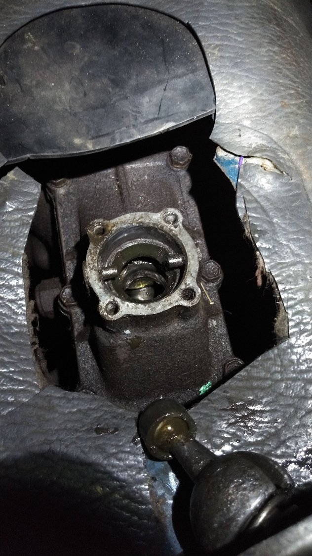

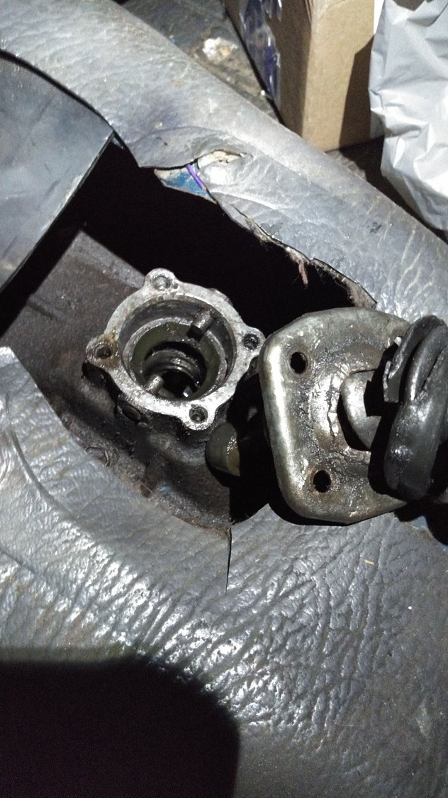

Recently picked up a 93 22re 2wd 5spd. Been working on it and finally drove it around some. I'm guessing being a 2wd it's a w55. Shifter feels a little sloppy. It will shift to through all the gears fine. Shift into gear or reverse while stopped on the clutch but refuses to down shift while moving. Double clutching doesn't help. You can slide it back into the current gear but not down any. I have new bushings coming tomorrow but I'm not sure they're gonna do any good. I popped out the shifter and the current ones don't look too worn. The ball is pretty badly pitted though and someone mangled up the retainer cap pretty good. It's currently filled with just 75 90w gear oil. I've never come across this problem before. As soon as you come to a stop it will slide into gear. While moving if pushing into gear I don't feel a grinding. Just won't go until you come to a stop. Have a chance to pick up an 88 2wd trans local. Should also be a w55? Anyone have a shifter lever they want to sell? W56 the same?

Actually now I have no idea what transmission this is. It's not the twist lock shifter retainer I'm used to

I pulled the trans out tonight after realizing how trashed the wallowed out the shifter seat ring was. Also found a piece of metal hanging out in there. The shifter retainer collar is also so trashed if you tighten down the 4 bolts on it you can't even move the shifter. Picking up a used w55 saturday
