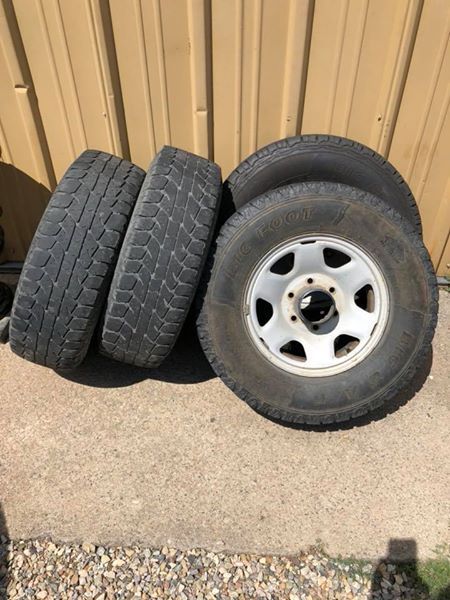

Can anyone verify if steel wheels from a 93 truck will fit an 88 4runner? The front wheels have a sleeve for the locking hubs and since mine are aluminum they do not.

Sleeve??? A picture of that of which you speak, please.
Everything I know says they will fit just fine.

These are the wheels. Thanks for your input.

That sleeve is only cosmetic. It can come off if necessary.
Steel wheels DO require different lug nuts than Toyota factory alloy wheels do.

The correct Lug nuts are a must !!
