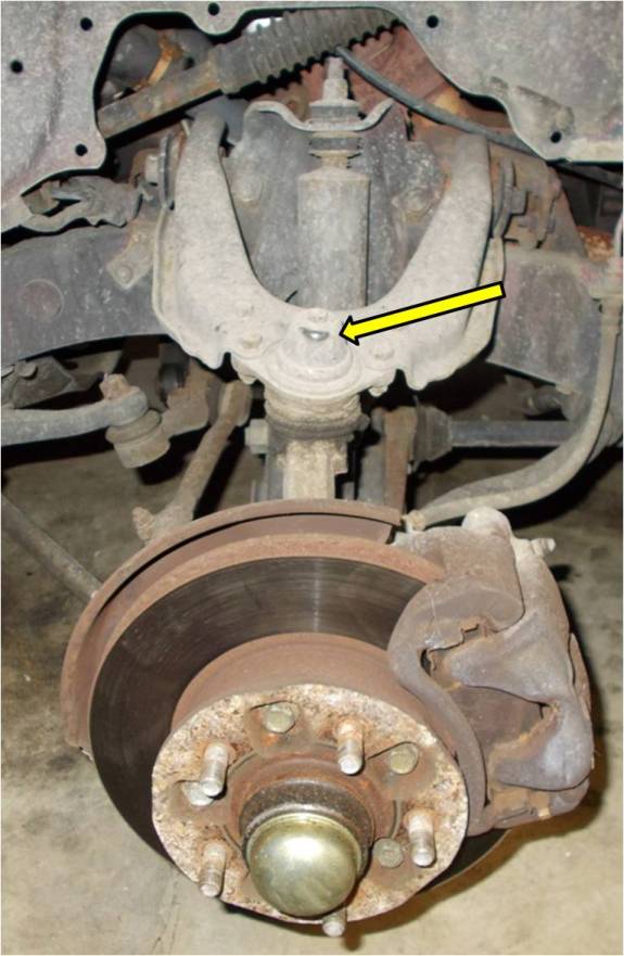

They fit the rear hubs just fine, but up front they rub here:

I was only out $40, so I took my chances with a set of 15x6 rims from a 2013 Tacoma instead. The bolt pattern is correct, but the hole in the center of the wheel is too small for the truck's hubs, front or rear.
The only rim I have (besides the ugly alloys) that fits both front and back is this, and I only have ONE of them:
I really want to mount the 2013 rims. Is it safe to bore out the hub hole to fit the larger hub? If so, I'd have to give up the center caps or switch to full wheel covers. Adapters, maybe?
A couple shots of the front and back minus the wheels:
Is the front already wearing some kind of adapter?

That's just how the front hubs are vs rear drums. I gotta say, I kinda like those alloys.
