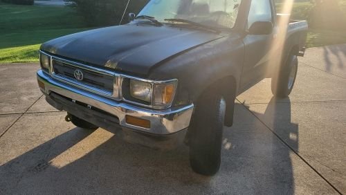

History of my Truck
I have had this truck for 12 years, I probably only have put 6k miles on it all that time (it's at 189k), it's one of those things I only drove it to haul things or use in bad weather since it's 4WD. For the first 9 years I had 0 problems with this truck, I could park it all winter and it would start like as it if rolled off the show room floor, love Toyota. 3 years ago the alternator was going out on me, I parked the truck in my back field for a couple of years because I had health issues at the time. When I decide get it running again, I wanted to make sure it ran before I put an alternator in it. I was disappointed it wouldn't start, I drained the fuel tank, put in fresh fuel, it would crank over but wouldn't start. When I reached in at manually open the MAF while my wife cranked on it, the truck started right away and died as soon as I let go of it but couldn't get it started again after that, so that's why I put in a new MAF. Of course since that wasn't it, it wouldn't start again, even put in a new TPS on it, when I checked the diagnostics and saw the fuel pump wasn't working so I figured that was it. Dropped the fuel tank, and that's when I noticed the fuel pump wire was chewed through, I went ahead and put in a new fuel pump, tested the old on and of course it ran fine. .After that it started up like it always did, no problem, I then put in the new alternator and it's been running fine every since, well until now.....

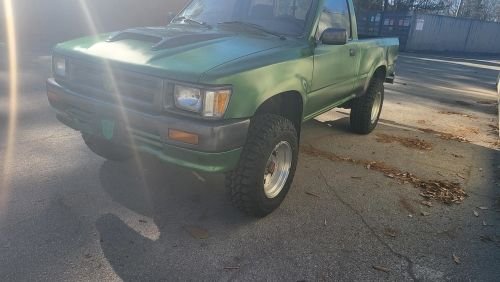

I decided to show the old truck some love since she's been so good to me that I did a budget restore on it for fun, cleaned up the rust on the under carriage, did minor body work, roll on bedliner, put on new tires and then painted it to show off all the dents and dings that I didn't fix.
