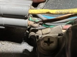

Old Jul 31, 2023 | 06:58 PM
2 toyotas's Avatar
Joined: Jul 2023
Posts: 3
So this is where it all started. This is the tan wire in the plug on the igniter. It ground out on that little hook there by the screw. That tan wire turns into the B-R wire. I don’t know where that B-R wire gos and what else it controls.
