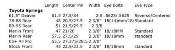

Found some cheap leaf packs from a 93 and I wanna swap or add a leaf from em to my pack. They are 3 inches longer, same width, and the center hole is a bit off. What problems will that present me when attempting this? Whos done this b4?

Use your main leaf from your 88, and add others from the 93 pack to get what you want. Cut them down/re drill the center hole if you need to.

Yah, thats what I was thinkin. Just trim the ends down to get the hole to line up. It was a stupid question cuz after I posted it I was like "duh" haha. Oh well. A mod can delete this if they want!
