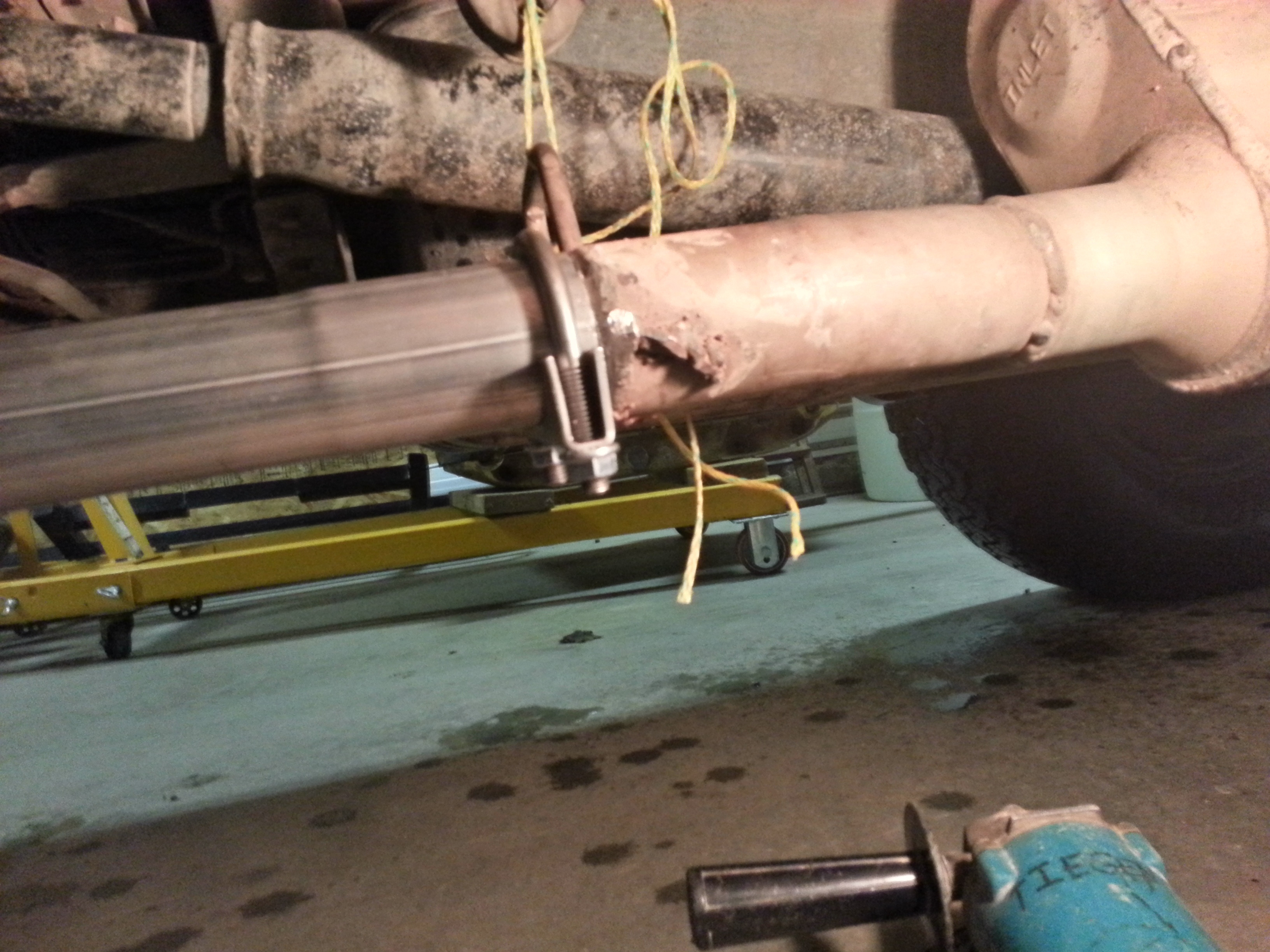

Step 1: Take your grinder and cut off the hanger that's now conveniently in your way.

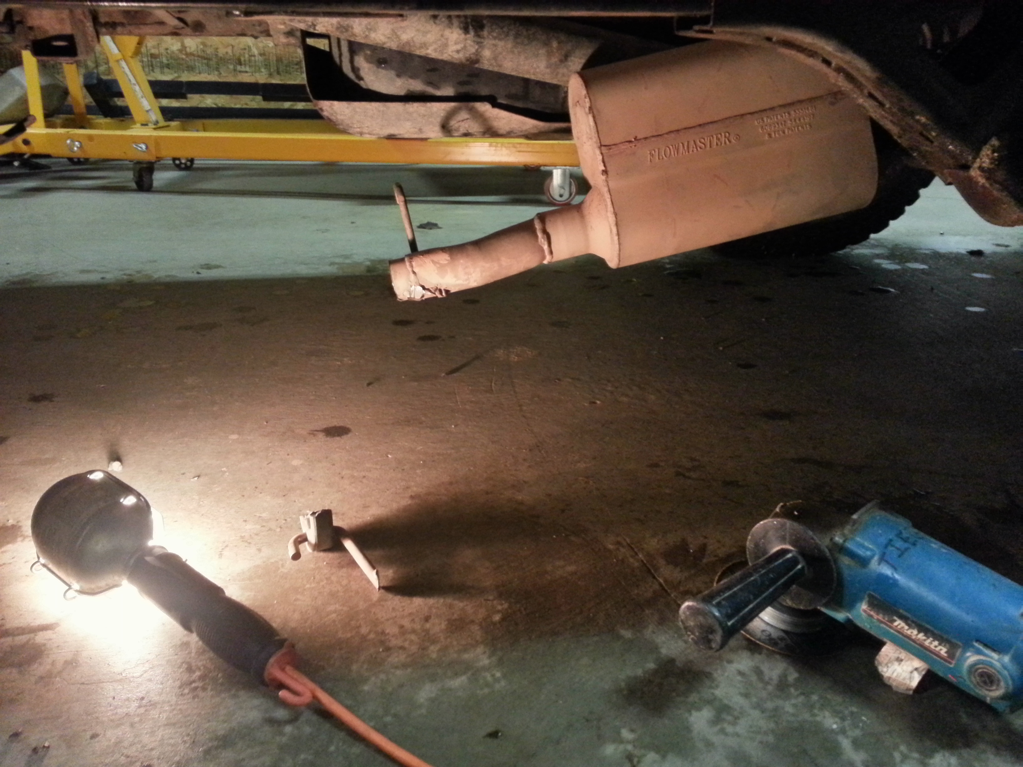

Step 2: This time with a grinding wheel, take down the crappy welds that held on the hanger.

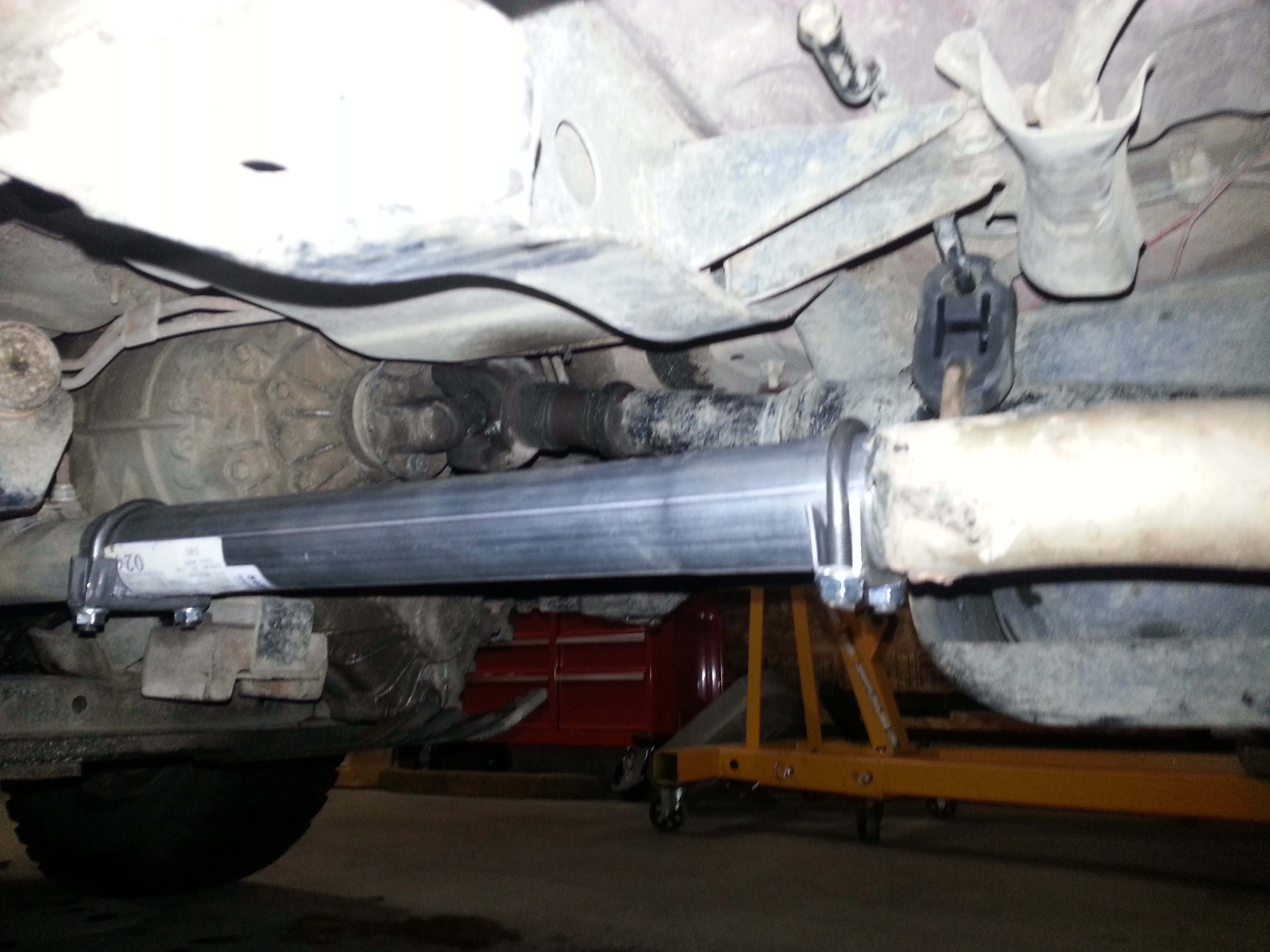

Step 3: Mock up your new 2" ID straight pipe making sure the crackhead left you just enough room to get a clamp on.
