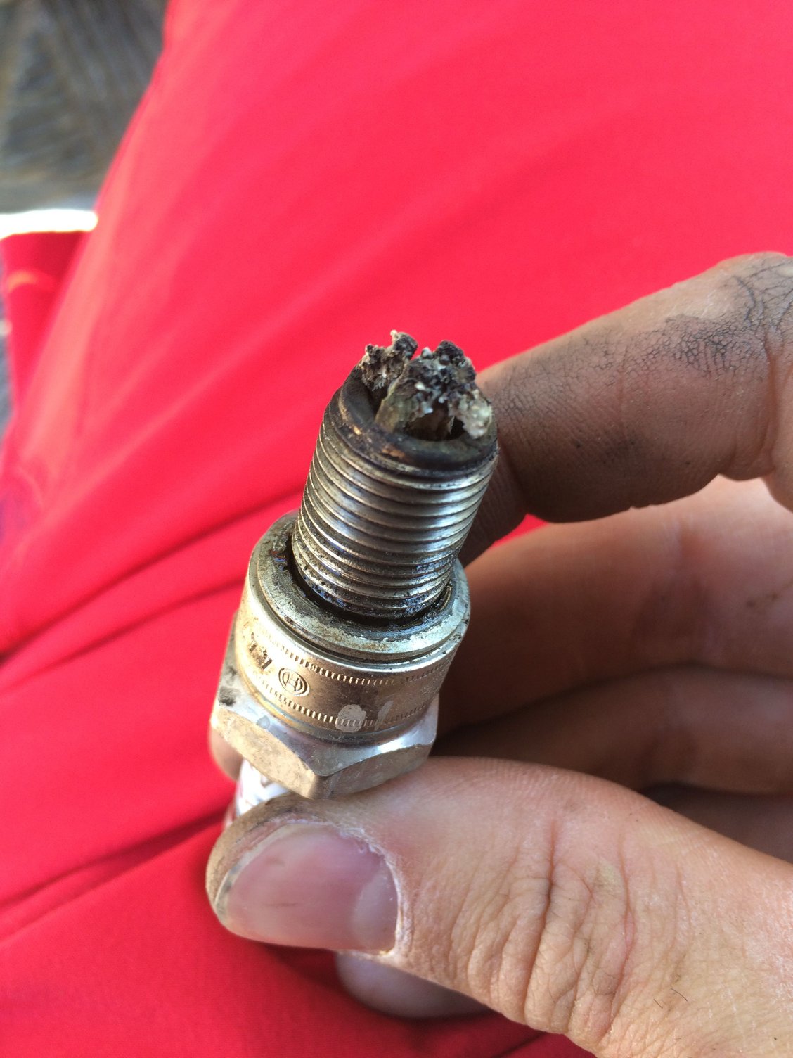

Changed the spark plugs and wires and they looked horrible! The plugs are all crusty. Never seen this before. Burning antifreeze?

I don't know what is going on with the engine for certain, but those old plugs are definitely the WRONG spark plugs for the 22R-E engine.
The best replacements are: NGK BPR5EY or the Toyota OEM Denso W16EXR-U
The plugs you took out look like ones for a newer Toyota engine.
Someone else will chime in about what the color of the crusty bits on the spark plugs mean. You can also do a Google search and you will probably find an explanation on the colors of old spark plugs.
Here is what I have found: https://www.ngksparkplugs.com/about-...d-a-spark-plug
And: http://www.ngk.com.au/spark-plugs/te...-plug-analysis

Thanks for the links. It appears the deposits could be from oil. None of the plugs were wet or oily when I pulled them, though. The plugs I replaced them with were supposedly the correct plugs. I don't have the part number with me, but I can check it out later. The new plugs only had one electrode.
