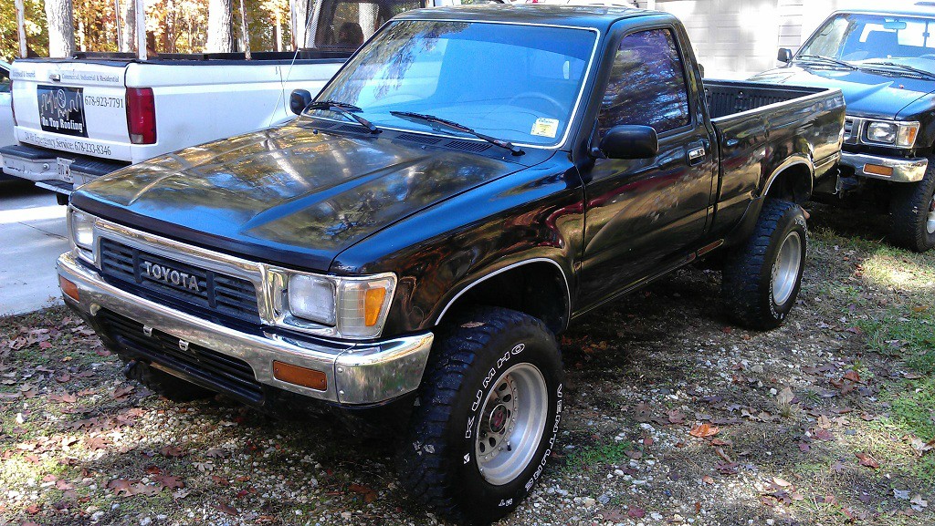

Been looking for something reliable and more offroad-oriented for a while now (First truck for me), and last week a nice little '91 popped up and i picked it up the next day.
Lots of miles on her, paint is so so and the interior is okay, but she seemed mechanically not too bad, plus i got a great price.
Picture taken before picking it up.

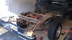

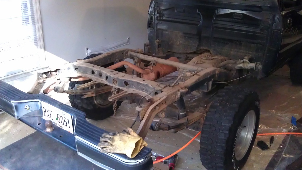

Brakes were pretty bad, especially after i did an emergency stop and my pedal went to the floor. Checked the lines and noticed a leak right at the fuel tank, so off i went to pick up some brake lines and connectors. Pulled off the bed for better access as well.
Once the line was fixed and the system bled (and the fuel pump wire fixed that i accidentally pulled off...), i was rather surprised by the sheer braking for of this thing .

NICE-looks a lot like my '91 except with better tires. Looking forward to seeing more of it.

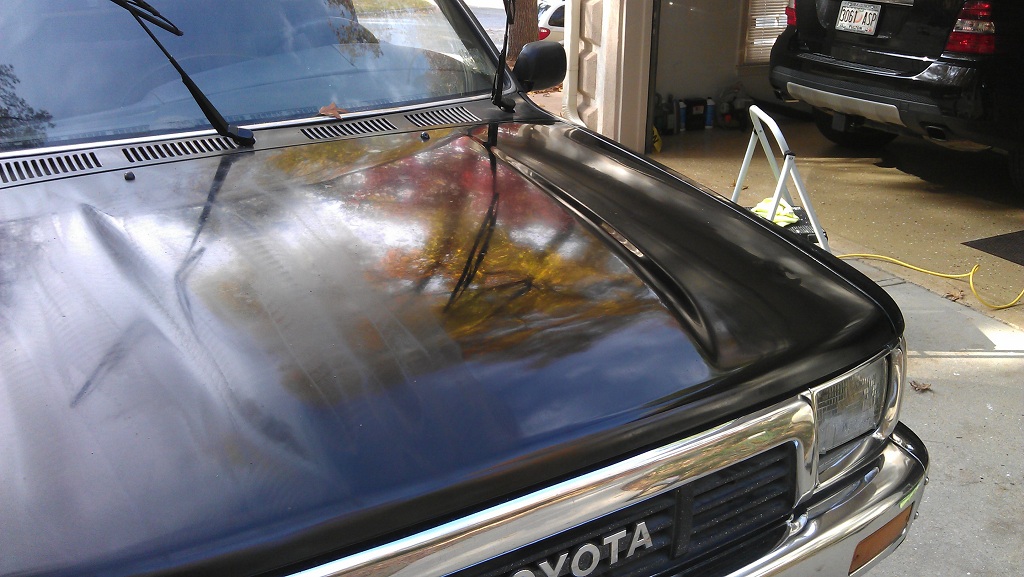

After finishing that stuff up, and reconnecting the airflow wires which i forgot to connect , i started on the body. Pulled out the old buffer and started polishing everything. Mind you, i didn't have much hope since the hood and roof have some really bad oxidation, but regardless, i'd rather try to salvage what i have left and make it last for a while.
3 grades of buffing later, the hood started to get a bit of a shine back. The water spots, sadly, are still there, but one can't have everything . Comparison pic. Right side of the hood is with the wax polished off.

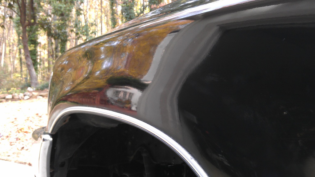

Like i said, hood and roof were the worst part. The rest of the body has some fairly heavy dings and dents and such, but the clear-coat is in decent enough shape to get a nice shine.

If you still have the bed off, double-check all the fuel lines running to/from the fuel pump area; they like to rust out there. Clean out any goo that's collected there.
