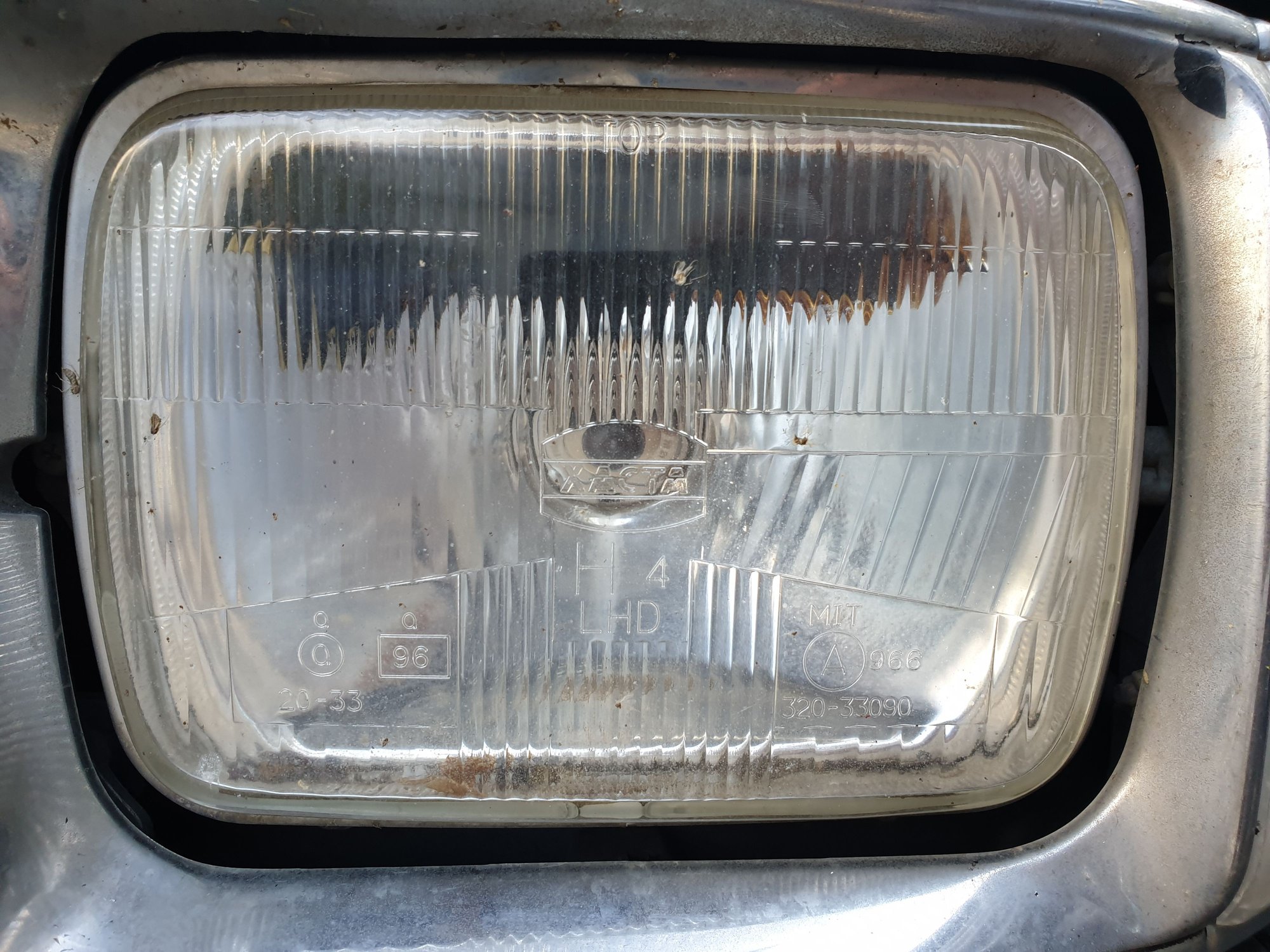

I read some of the topics about headlights trought the years, but I still have some questions. So, my headlights currently are like this:
Driver side:
And passenger side:
They are two different types and its awful at night, paired with the standart halogen bulbs. When I bought the truck, it had HIDs, but they destroyed the light switch and after replacing it I threw them away for the halogen ones.
No I wonder what should I do:
- go for fanless LED bulbs in the same housings? (probably not a good idea due to wrong geometry for the light)
- go for a complete set like the Holley Retrobright 5x7? (Costs a lot and can you replace the bulbs in future?)
- something else?
Thanks in advance for all the help!

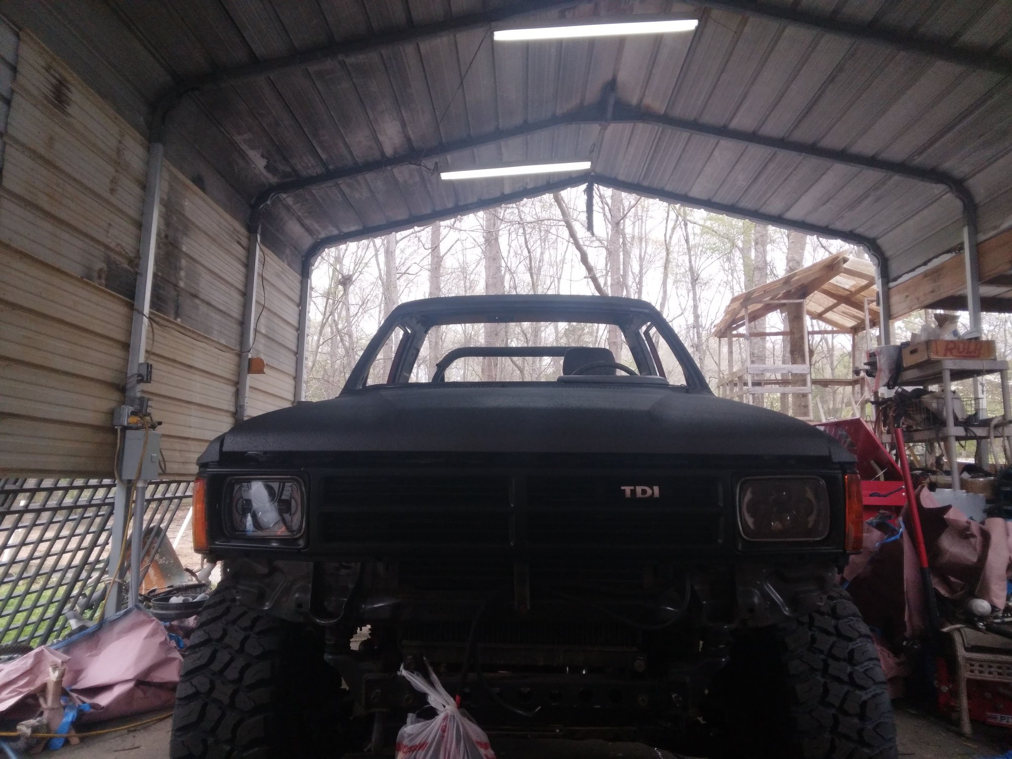

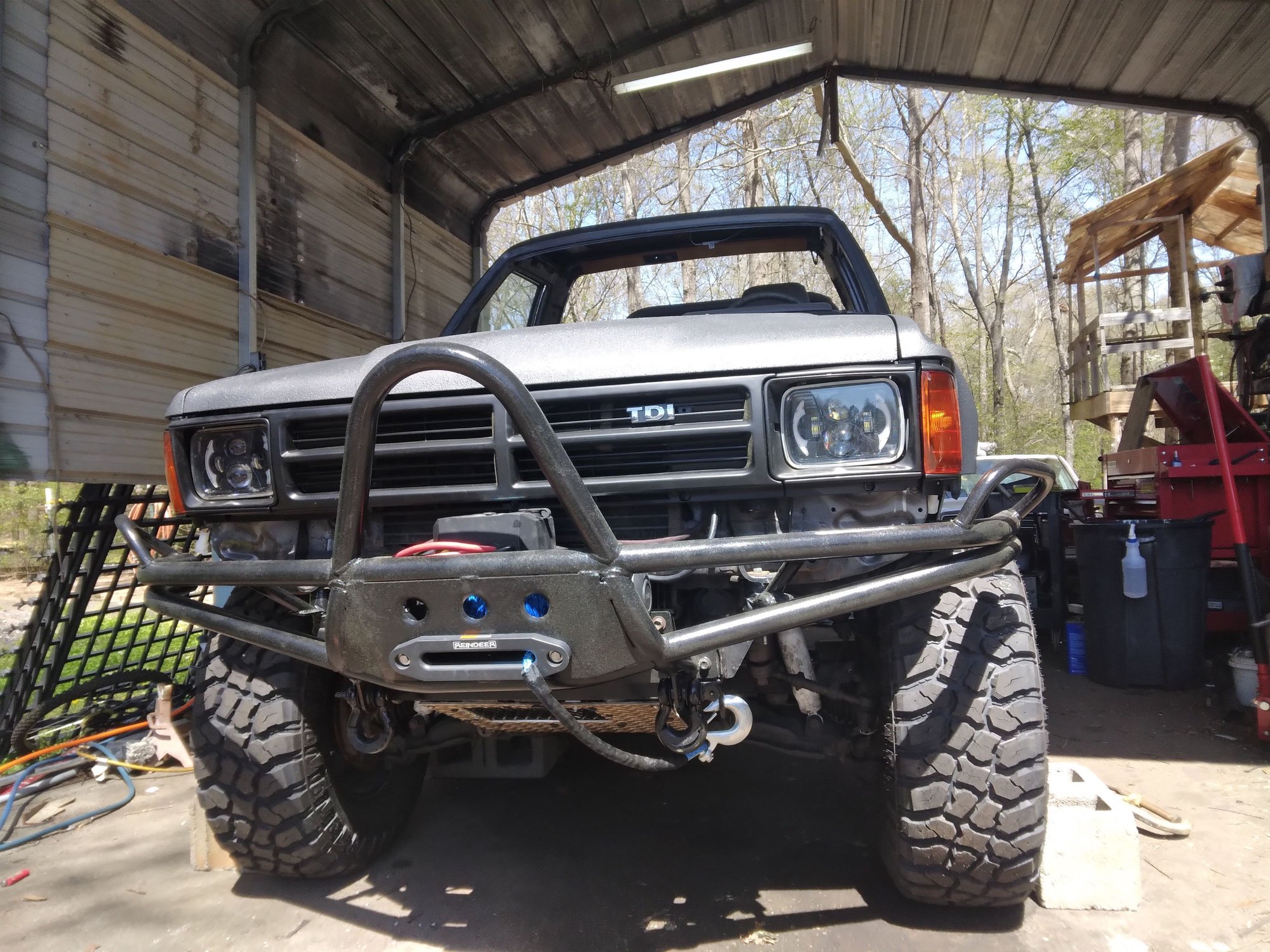

I'm very happy with DOT approved led projector using an h5 (or 4) conversion harness.
I have an aftermarket front bumper so integrated LED signals are also convenient but I had to cut a resistor out of my blinker relay to slow down my flash speed to normal.

Night vision is near on par with my 2004 VW Passat, which I consider great compared to my excursion.

Same here. The previous owner used zip ties to hold the grill at its place. By the way, here in Europe, there are far less options for 4Runners. Beside 2-3 cheap seal beam solutions, I found only Hella 1AE 003 427-011 as a housing. I think it will fit pretty well, here are the dimentions:
And yep, europeans don't offer the H4 harness kit as well. You guys in the States have a MUCH better market. Salute!

That is very kind of you! However, I got good news - I tried installing led bulbs in the current housings and what a surprise: they work. Low beam and high beam work and shift as normal from the light switch . I guess some previous owner convert the truck and now it seems it is simple as plug and play Meanwhile, I ordered the Hella housings and they will arrive next week. Will update the thread with fresh pics once I install them in place. Cant wait
