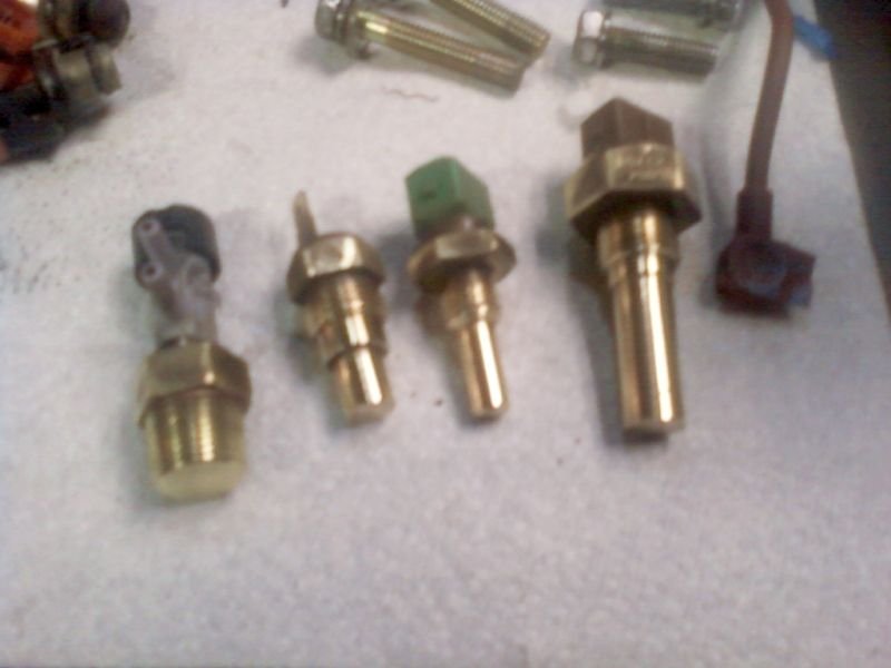

was it doing that before or was it better?
does sound like the CST is bad pull it an check its readings (just incase a wire is involved) give it a good clean bright shiny brass then test it again a lot of the sensors get crusty an stop working right
these are mine when i did my engine rebuild

borrowed from another thread here on yota tech
the bottom picture shows their location on the engine now this isnt absolute if the engine has ever been touched before the switches might be in different spots so grain of salt here
Seen from the front of the engine, right to left, they are:
1. Engine Coolant Temp Sender
2. Engine Coolant Temp Sensor
3. Cold Start Injector Time Switch
4. Engine Coolant Temp Switch
5. TVV/BVSV for the EVAP
The black plug should be the cold start injector time switch
PNC 89422 is the Engine Coolant Temp Sensor
PNC 89462 is the Cold Start Injector Time Switch
PNC 89428A is the Engine Coolant Temp Switch for the E.F.I.(not for the A/C, or the A/T)
Blue arrow: Engine coolant temp switch
Red arrow: Engine coolant temp sensor
Yellow arrow: Engine coolant temp sender
Green arrow: Cold start injector time switch
shows location on engine
