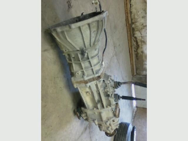

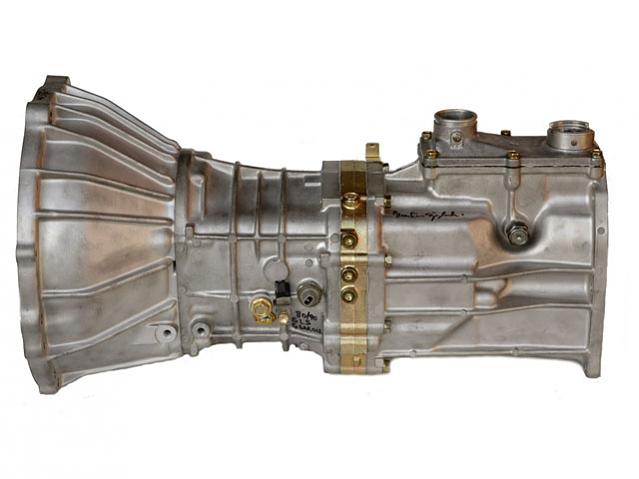

I know most of you guys have no problem swapping out transmissions and motors, for me its a different task but I'm willing to research and try doing it myself that's why I here today. I have a broken tooth on my reverse gear, 91 pickup 22re 5speed 4x4. has the W56-C from what I can tell from the door tag and web sites. I located a transmission and transfer case all bolted together from another 91 the guy didn't know what type it was but from the pic's they sent me it's seems to be a 5sp G54 from comparing the pic's on Marlin Crawler inc.
(http://www.marlincrawler.com/transmi...built-complete)
I'm trying to find out before I buy it, If it will fit, this is all new to me which I think it will fit, but not for sure, every thing seems to be the same gear wise, but there is some differences as to a single shifter plate on top and electrical connections on the side of the W56 compared to a double shift plate on the G54. I have tried to research this before posting, this is one of the sites off this forum with a lot of help full info
http://www.4x4wire.com/toyota/faq/parts/
Can any one out there jump in and maybe tell me if these two trannys will swap out OK, a W56 bad reverse for a G54? I'm thinking the speedo cable might be different and maybe the connector for the 4x4 indicator light and backup lights ( and I'm guessing at all this guys ) but from the pic's the wiring is a little different on the G54. Just not sure what I'm gonna run into.

First of all Thanks for the Reply ,,,, I agree, If It WAS a 91 it should be a G58, I think the seller was not sure of the year of the truck it came out of. According to The pictures he sent to me I'm pretty sure the transmission is a G54 and not a G58 comparing them to the pic's on the Marlin Crawlers web site, maybe I need a second opinion from you guys, but all I've got to go on is these pictures and most of you on this forum are really good at what you do, so I value your
opinions.
So in your opinion,,, If this Is a G54, could I drop my W56 tanny and tr/case, and swap it out with the older G54 tranny and tr/case? If It Is a G54? with out any issues? or any other cable, electrical, hookup problems.

You can tell if it is a chain drive or gear driven case by the number of bolts holding the back of it together. I believe this info is on Marlins site. The G54 is lesser transmission than the W56, but will swap in place. I swapped my G54 for a w series a few years ago. There are a few issues you will need to address. First is the rear output. The bolt pattern might be different than what you are running, either swap the output drive flanges or order the triple drilled flange from Marlin. The second issue is Floor board clearance. If I remember correctly the G54 has the shifters mounted slightly farther forward than the W series. You can always just cut the floorpan but will end up with a small hole in back of the shifter boot and trim ring that looks ugly. All the electrical connections on the transmissions I swapped were the same. It was an 85 G54 and the W56 was from an 87 I believe. Even the throttle cable worked

Yeah, that looks to be a G54 or G52.(same thing really)
Considering they are both forward shift (w56c/g54-52) there should be no problem. The only think i can think of being different is the boot.
