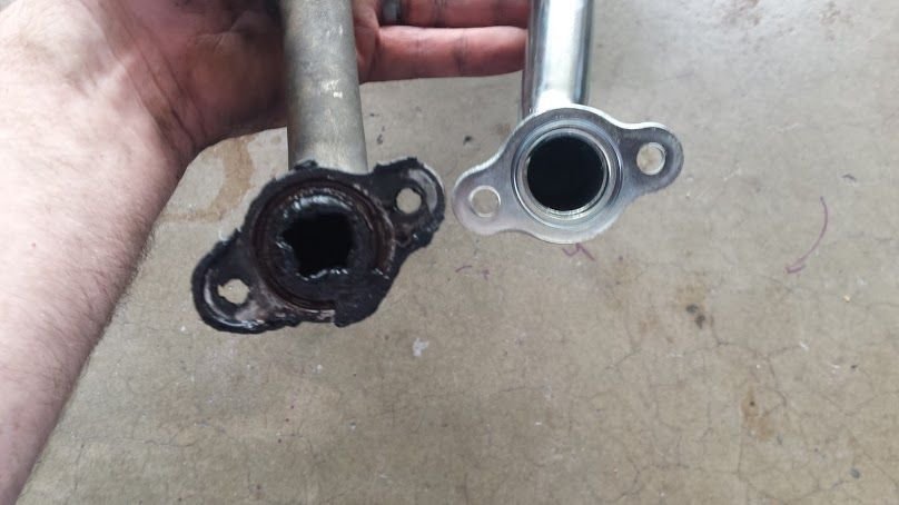

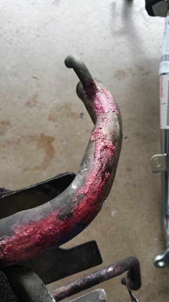

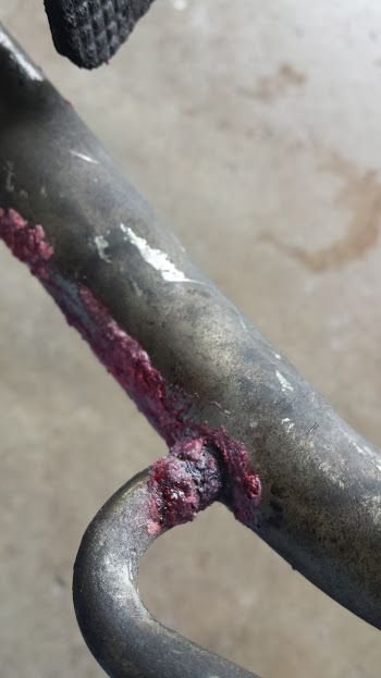

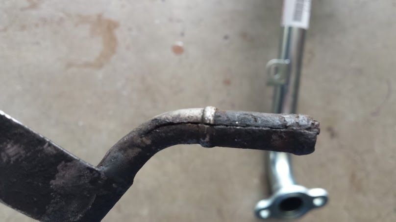

Problem was finally solved, was the tube under the lower intake manifold that runs coolant to the temp sensors. It was completely clogged. Installed a new one and problem was gone!
Old Apr 10, 2016 | 10:47 AM
  #43
mave605's Avatar
Joined: Jan 2013
Posts: 205
From: Reno, NV
It also had small cracks. I suspect that a previous owner had poured stop leak to try to fix a blown head gasket, which caused this tube to fail.

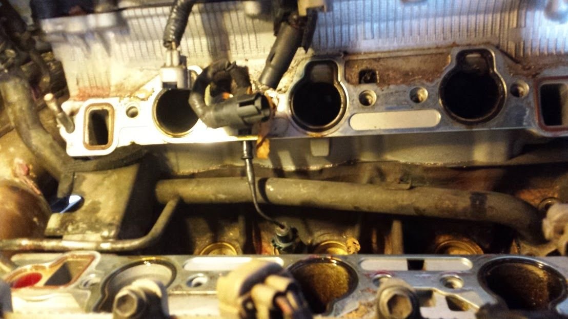

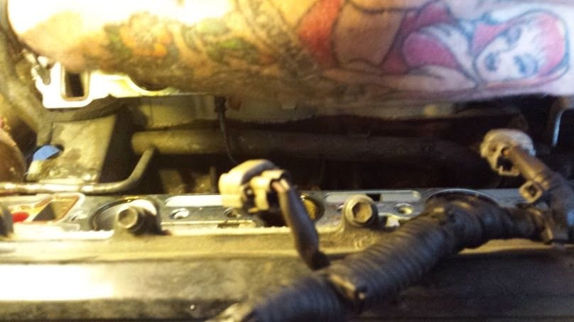

This is where it is located, next to the knock sensor.
