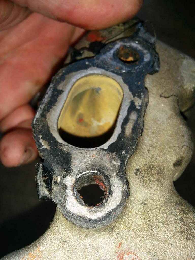

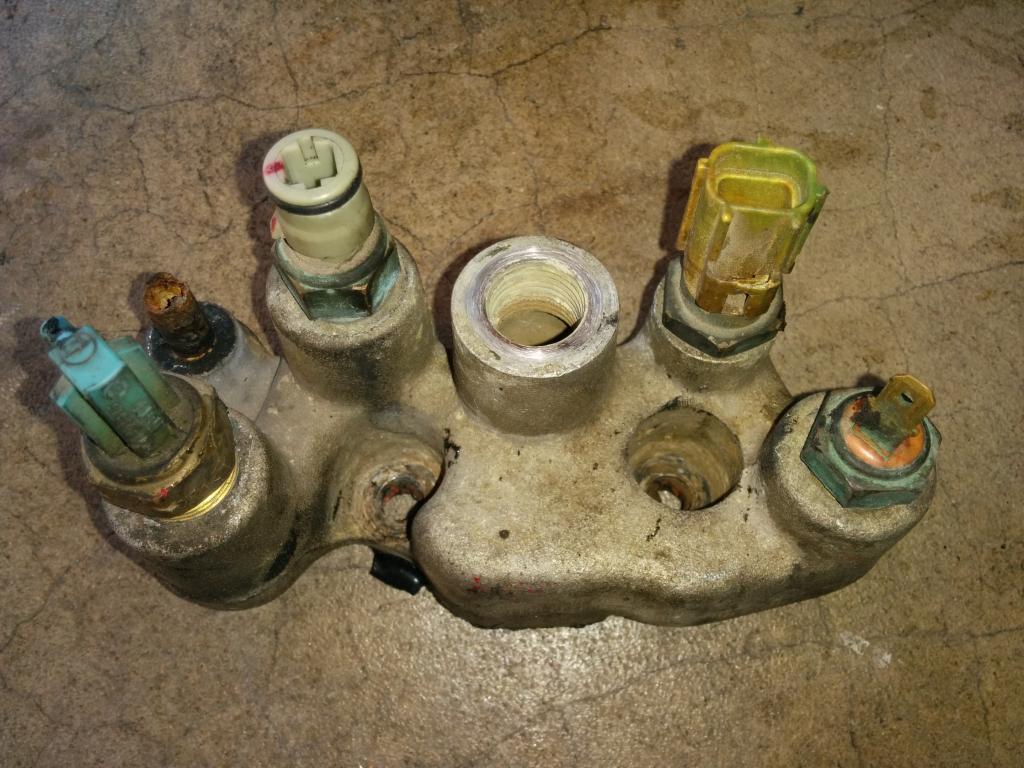

This is the sensor block out of my donor. I didn't replace the block with the engine rebuild. I did replace the sensors on occasion. One theory I have is that the coolant does not touch the sensors, that would explain why the gauge is off and why it runs crappy on cold start up.
A wired thing is that when I take a sensor off my 4runner, coolant doesn't flow out of the hole. It does when I remove sensors from other 4 runners. What could cause that?

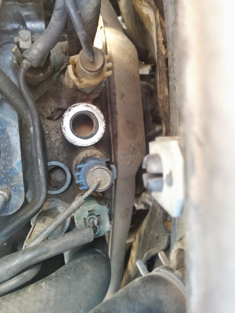

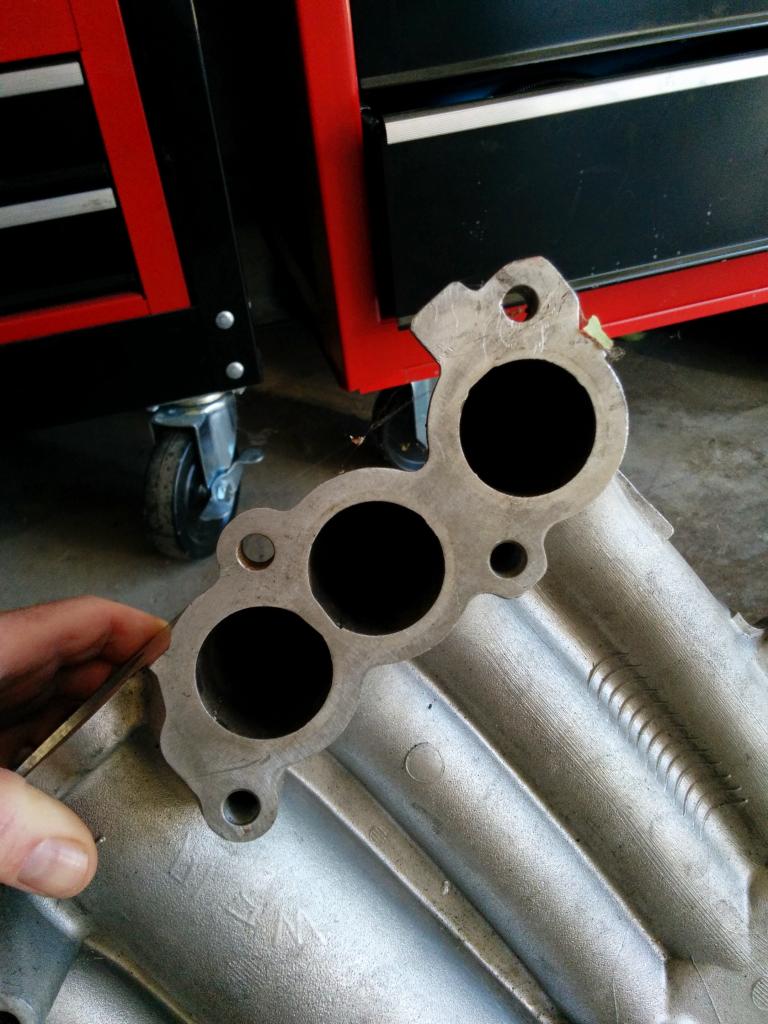

This pic is from a 1991 at the junk yard.

Just to clarify, there are two coolant temperature sensors, one to the temperature gauge in the cluster, and the other to the ECU. The sensor that goes to the gauge has no effect on engine operation, it only there to inform the driver as to what's going on. The other one that the ECU sees is the one that needs to be working properly in order for the engine to run properly at various temperatures.
Your problem indeed sounds like improper temp information going to the ECU. You may need to check the voltage at the ECT input to the ECU at various operating temperatures to see what's going on. Your Toyota dealer may have a diagnostic reader that could also tell them what the ECU thinks the engine temperature is.
Thank you for the reply! Yes, your right. The big green sensor is the one that goes to the ECU. The one in the middle that is missing from the block above is a black one that triggers the cold start injector. The one on the right goes right to the instrament panel. I think the whitish color one is for the A/C.
The wiring checks out, signals are getting to the ECU. As to the exact voltages at different temps, not sure. My brother is a master mechanic at the dealer. They only have FSM 1991 diagnostics there because people don't bring these old trucks in there that often anymore, couldn't locate one for a 1990.
Here is the weird thing. With the temp sensor for the gauge, it is not showing that the temp is warmed up even though I know it is for sure. I swapped in another instrument panel to check and same thing, the temp is showing off all the time. I went offroading today, engine was heated up fully while offroading, but only showed 1/4 of the way warm.
I have replaced that sensor with a known working one, and a brand new one. I know that doesn't control anything, but wouldn't it be logical if that one isn't showing the proper temp, with good wiring and a signal at the ecm, that the other sensors are having a similar issue too?

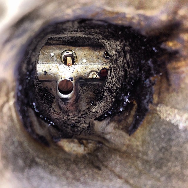

This picture is the cause of most problems in 4runners
Attached Thumbnails 90 4runner 3vze Hesitation Issues - 2 years of troubleshooting: The Ultimate Gremlin-1526739_10203009921428132_1054834729_n.jpg

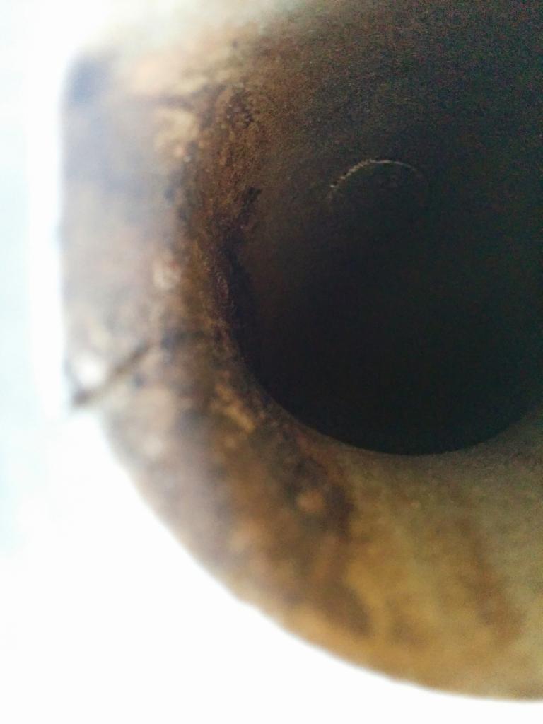

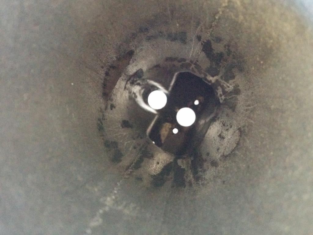

Yes I cleaned out my intake and throttle body very well before installing again during the rebuild. I also tried another cleaned intake and throttle body off my parts 4runner which didn't hesitate, but still had the issue.

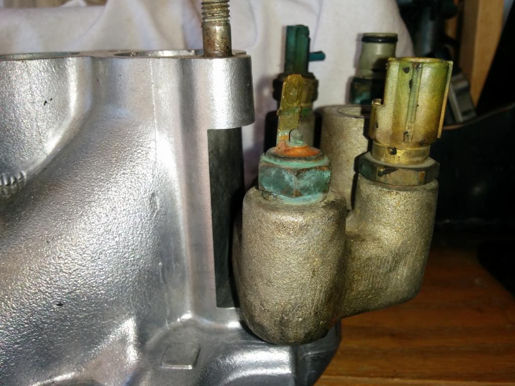

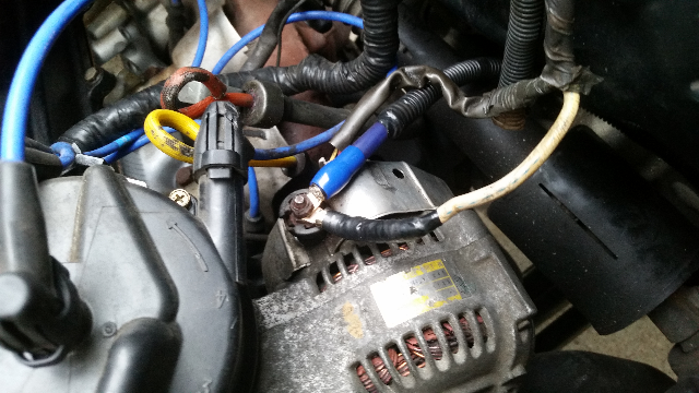

I checked the fuel pump circuit last weekend and it did have some voltage loss. I added a ground from the fuel pump to the seat belt bolt. It helped but still had a little voltage loss.
Do you have those photos or a link where you added the extra grounds? It may help because I added the extra power cable to the alternator. Thank you again for your advice!

Sorry I couldn't respond quicker. I tried taking pictures of how I did mine, but basically I just did the "Big 3 Upgrade" which amazingly helped with shifting, bucking, misfires, bogged down power. Completely changed the power.
90 4runner 3vze Hesitation Issues - 2 years of troubleshooting: The Ultimate Gremlin-forumrunner_20141020_170611.png
I also repaired the old wire that connects to my alternator, which at times, if I use my windows the headlight fades, but that's just due to my alternator dieing, but the big 3 is helping it by giving it more of a break and more flow of power to the alternator without much resistance. Also just go through all the grounds you see in the car and just take them off, sand the base where there connected, and the terminal of the ground it's self, and just reconnect. I'll get more pictures of how my connections are, since there very well hidden. Also make a ground from your tranny to the chasis of the truck. I'm about to do that, but I know it will help, also with vaccum's Which play a big roll in the 3.slow, to check the metal tubes and see if there not clogged up. If they are just run 2ft of vaccum lines to where ever they connect to.
