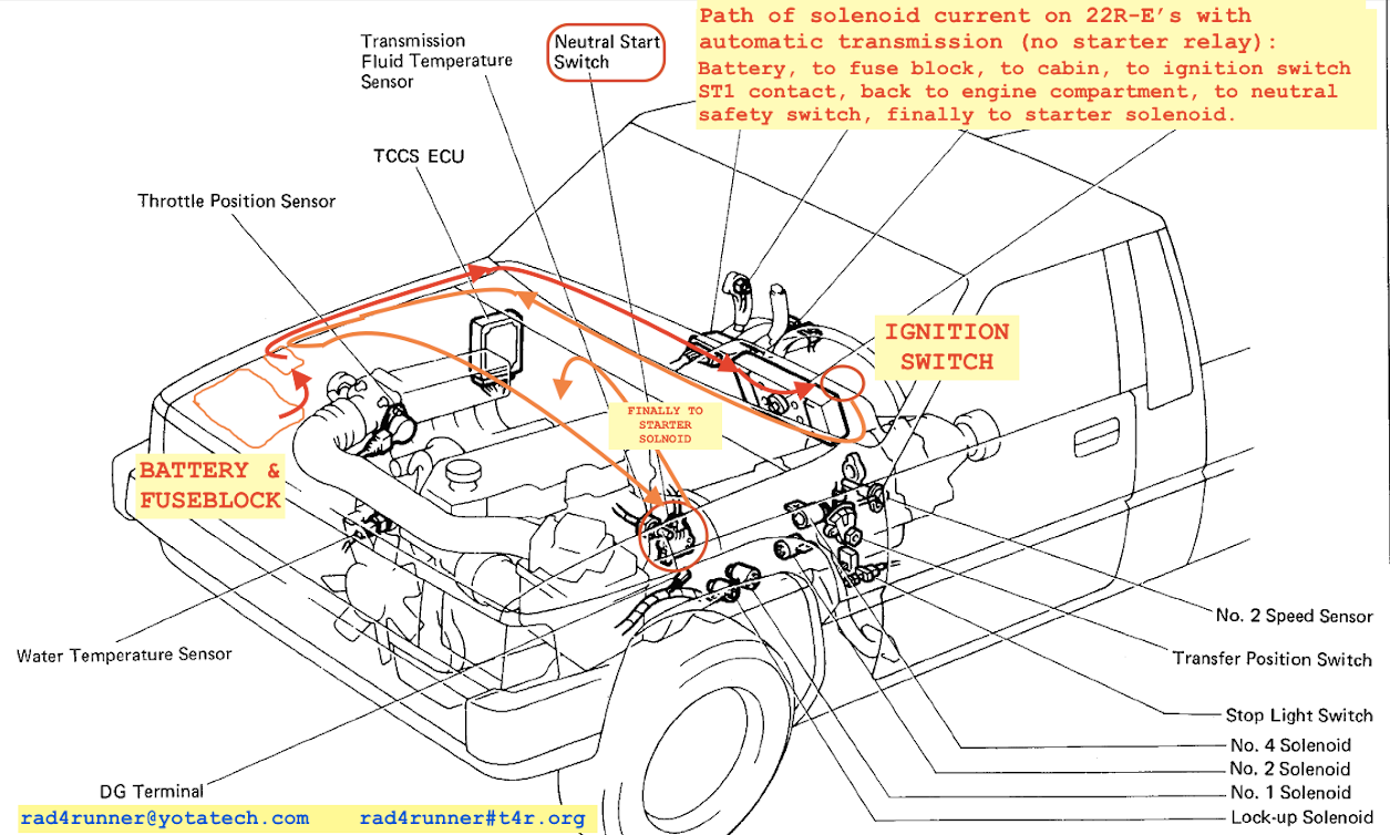

Automatic has NSS but no starter relay. That is the problem with many trucks up to 1995.
Look at the path starter solenoid current needs to take.
Here's how to troubleshoot:
https://www.yotatech.com/forums/f116.../#post52422426

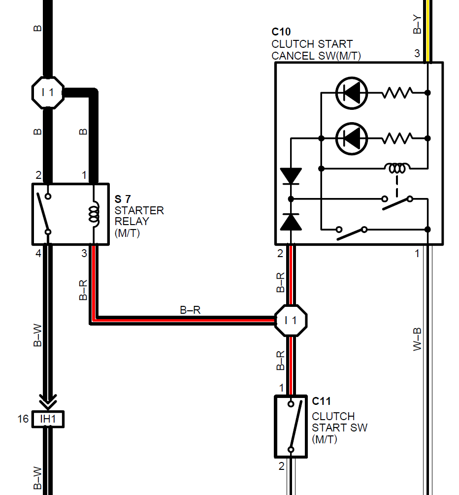

Just to confirm, starter relay is manual trans only in the 1990 4runner EWD.
A faint click makes me think starter solenoid is getting power but not enough amps to kick off the big switch inside to power the actual starter motor. I'd assume ignition switch would be at fault. I didn't check out the troubleshooting link above, but that's probably a good resource to start with.
How did you test the starter? Clearly the starter motor is good, but the solenoid is generally the failure point (click no crank). It's possible the new starter is defective. You can test it in the vehicle, but you'd want to make 100% sure it's in park and can't run you over (jack the rear tires off the ground works pretty well and leave in 2wd). Just have to run a wire (ideally with a fuse) to the starter solenoid wire (small wire) and the starter should click and crank the engine. It draws quite a lot of power, so 30-40 amp fuse, and 14 gauge or larger cable would be ideal. Pretty sure it's just a standard 1/4in spade terminal, so could make up a test lead pretty easy and make the connection at the battery for testing (and safer, less risk of shorting out to ground, etc).
Kind of a side topic, but adding a starter relay looks pretty simple based on the drawing above, just would have to tap into the wire before it goes to the starter, make that energize a relay (probably 30-40 amp rated), and have the relay jump power direct from battery (not through the ignition switch) to starter solenoid. Odd that autos didn't have the starter relay while manual did, I wonder what logic was behind that at Toyota.

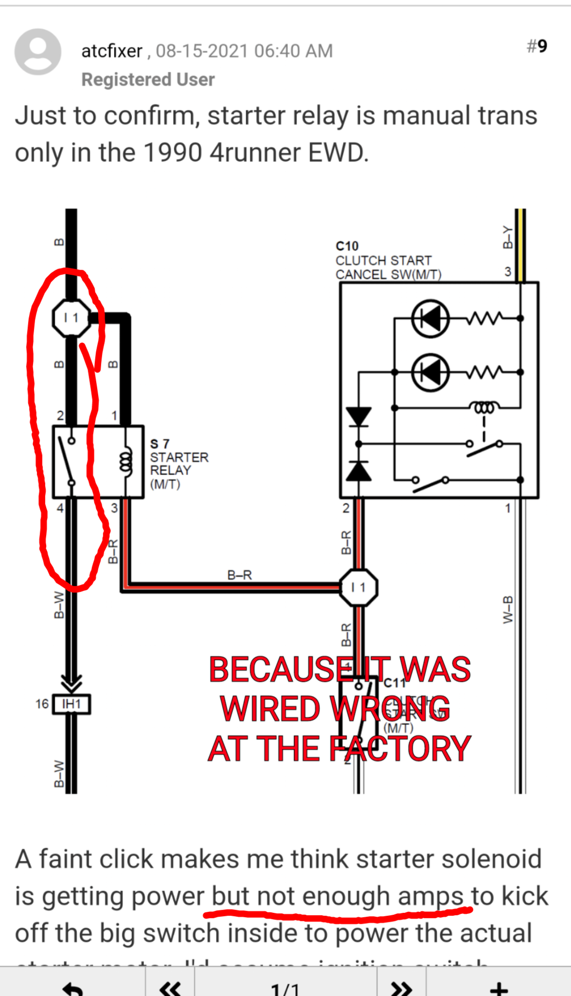

Manuals with starter relay WIRED WRONG AT THE FACTORY. Toyota's electrical engineers in those days not as brilliant as its mechanical engineers. Look at the headlight, cranking and horn circuits.

That's nuts, I guess hind sight is 20/20, but amp ratings seem like a huge part of the wiring design. I just realized what you mean exactly by being wired wrong, the power source is from the ignition switch, there's no point in the relay, just overly complicates the circuit xD. I bought a truck for parts a while back that had the starter relay bypassed with a short pig tail that just shorted all of the wires together. I guess it makes sense to make something like that since the starter solenoid does nothing to help the circuit, the tiny bit of power it draws actually makes it worse!
Horn circuit runs power directly through the steering wheel, pretty crazy, not sure how many amps it's designed for, but 100% don't put big horns on the factory truck's wiring.
And for those reading along wondering what the issue with the headlight circuit is, it's almost right, but the ground side of the headlight runs through the actual dimmer switch, even though the power side is ran through a relay like it should. Again, don't put high wattage headlights on the old yota trucks unless a relay is added in and power source is from the battery (ideally with a fuse).
I wonder if there's a demand for a kit to fix those issues to make things wired the correct way. I make harnesses, pig tails, adapters, etc so I can probably get connectors to tap into the wiring with no splice work, and wiring things correctly would make the headlight switch, horn (the switch and round contact), and the ignition switch likely last a LOT longer, but at the same time, the kits would probably cost as much as replacing the parts once.
For fun, I looked when Toyota fixed those issues.
Horn issue, fixed in 1992 for pickups (aka 91 has the issue still)
Starter, fixed in 1992
Headlights, never fixed, power from relay, grounds through switch still (I think a LOT of toyotas run this design, maybe the switch is designed for the 120w+ draw (10amp+).
Jumping to a 1998 T100, headlights still grounds through the headlight switch. 2005 Tundra, same basic design. Checked a couple other vehicles, all the same style. I suspect for electrical issues, the 3 highlighted above are probably common issues.
Thought of another circuit with a high draw, wiper motor, it's designed right though, odd that they got some stuff right but some way wrong. Makes me want to go through my vehicles and check their higher power draw circuits and make sure relays are correctly used lol.

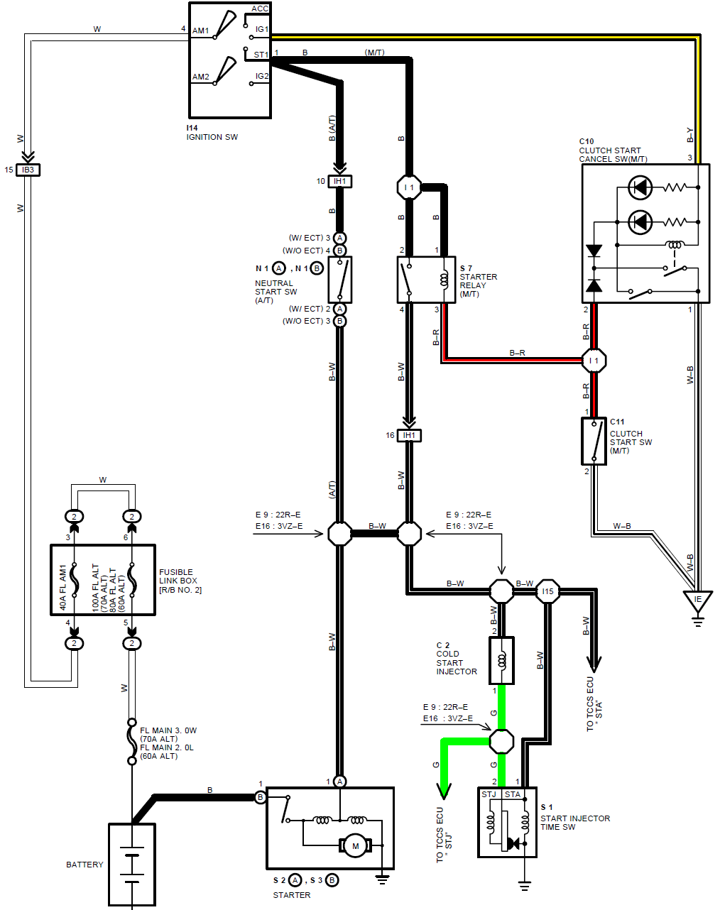

That truck should have just a neutral switch (park/neutral) and the actual ignition switch. There's no starter relay in the circuit, just the starter solenoid directly on the starter.
Here's the full starter circuit, the A/T notes are for auto trans, M/T is for manual only (basically everything on the right top area).
