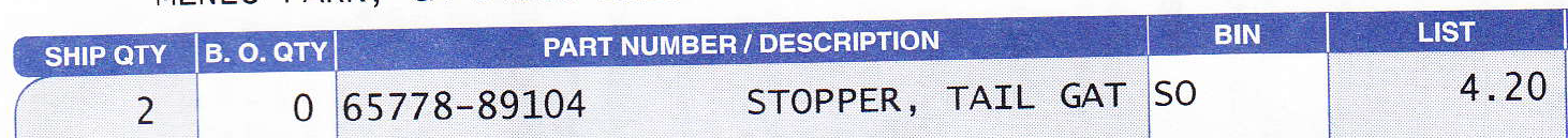

Are you sure that's where your rattle is coming from? I ask because I've found the two hanger straps on either side of the tailgate to rattle when their little plastic anti-rattle brackets break -- I'd check those first.
As far as I can recall, those torsion springs under the tailgate to lighten the load are under tension at all times on my '87.
Here's a part # for the anti-rattle plastic parts that go on the sides of the tailgate opening to keep the hinged straps from rattling.

there are four of the anti-rattle clips used. 1 at each side on the body opening and one at each side on the tailgate.

Thanks Blueman. I'll certainly order a set of those as both of mine are broken. However, after taking time yesterday to narrow down where the rattle was coming from I wrapped the tailgate hangers with pieces of inner-tube, and tightened a few screws in the tailgate inner cover. It was while I had the inner cover off to lube the rear window regulator and with the tailgate closed I was able to reach in and move the right torsion spring back and forth. Which is what I'm hearing when driving. I didn't check the left...
