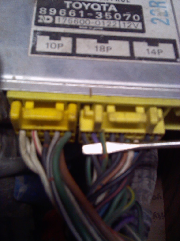

What part number ECU are you using?
The numbers on the ECU are kind of thrashed. The top number looks like 39661-35020 or 89661-35020. Here's a picture of it.

OK that ECU 89661-35020 comes from a 1985 22re I have the same one in my 85. If you want to run a 1988 ECU you will need part number 89661-35130 if its California emissions or 89661-35110 if its federal emissions. I would try to get the 89661-35110 federal since I don't see an EGR temp sensor or air injection on your engine. My 88 has both air injection and EGR temp sensor and I run a California computer. The reason the connector is not there for the o2 sensor in the engine bay is because the harness that the connector would be on 85-87 stays in the truck when the engine is pulled. I would try to set your timing and find out what codes your getting. For right now you could run a wire from the engine bay o2 sensor into the cab and to terminal ox on the ECU. Or you can use the o2 underneath the truck but you would have to check and make sure its hooked up right. All plugs except for the injectors should be the same between the years. Let me know if you need help.

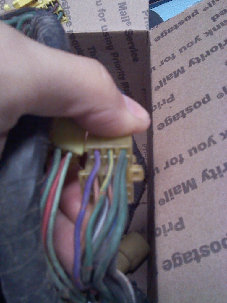

Sounds good. The wire you need to ground is in the 1st picture middle connector and 3rd from the left, should be green with a yellow stripe. It looks like this wire just runs about six inches to another connector shown in the bottom right of the 2nd picture and would plug into your vehicle harness. Shown better in the 3rd picture. On 85-86 that wire would run from the bottom connector to the vehicle harness and then to the driver side fender where the round diagnostic plugs would be. On your 88 that wire should run from the ECU and just quit right at that bottom connector in picture 2, I don't think your vehicle harness would have this wire on the other side.

BTW the harness and computer in the pictures come from an 85-86 so it should be the same harness you have in your truck.
Perfect. I'm not going to be able to look at the truck for the next few days (I'm out of town) but I will have a look next week.
Ah, I'll see exactly what's up w/ that connector in picture 2 on my truck. I haven't actually investigated if the vehicle harness is still '88.
