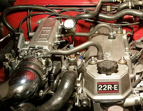

A fuel pressure test would be a great idea. I have a kit from LCE that mounts a fuel pressure gauge right on the cold start injector. It's about the same cost as any other gauge. $54 bux
http://www.lceperformance.com/Fuel-P...-p/2019128.htm
This is what it looks like installed / where it goes. Very handy, stupid easy to install

got the pressure gauge today
So I put the pressure gauge that was recommended in and it is only running at 33 or 34 at an idle hit the gas and it drops to practically nothing so I ordered a fuel pump hope that's the for sure problem
