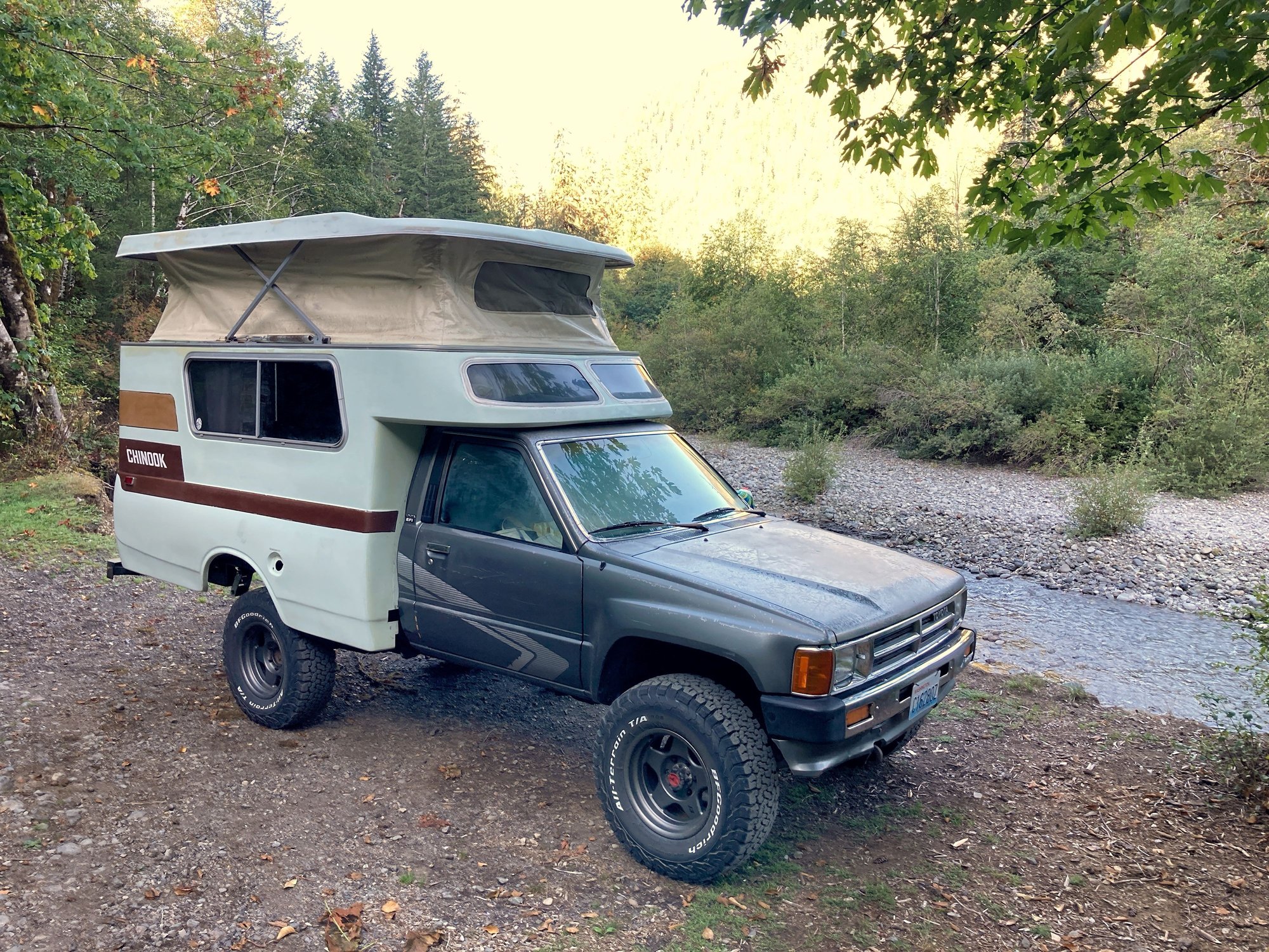

Here is the current state of the build. Trying to dial in everything before I start the process of thinking about having it repainted.

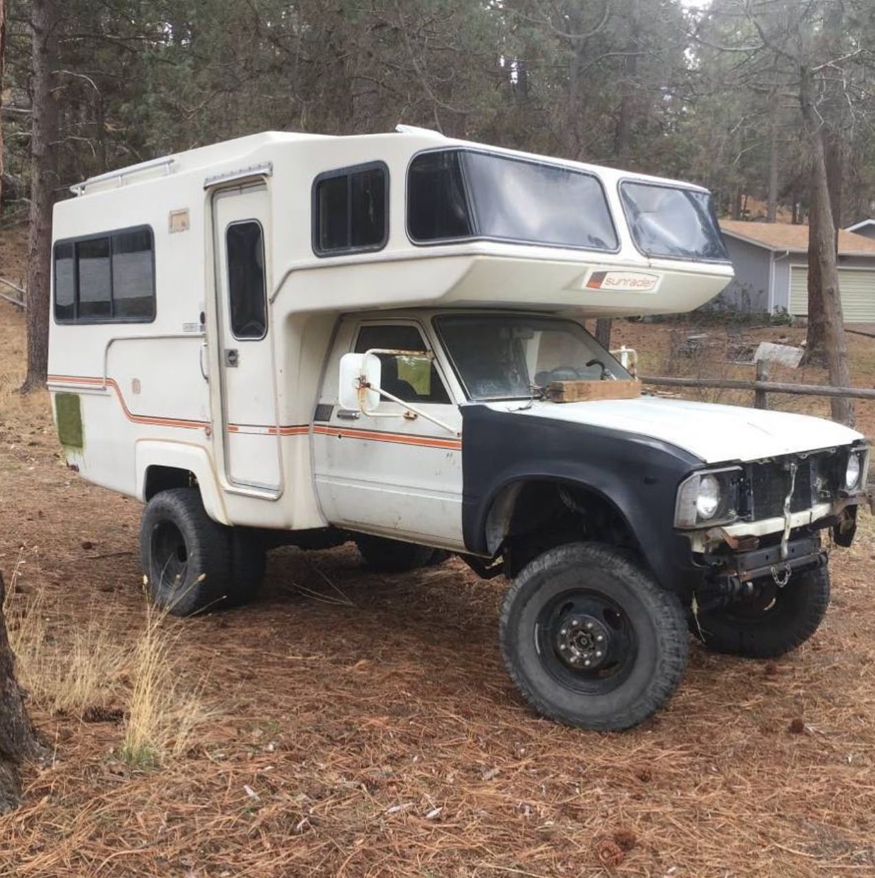

sunrader was neat, my honest opinion the chinooks a way better platform, more room= more crap, more crap in an underpowered vehicle with a lift is misery

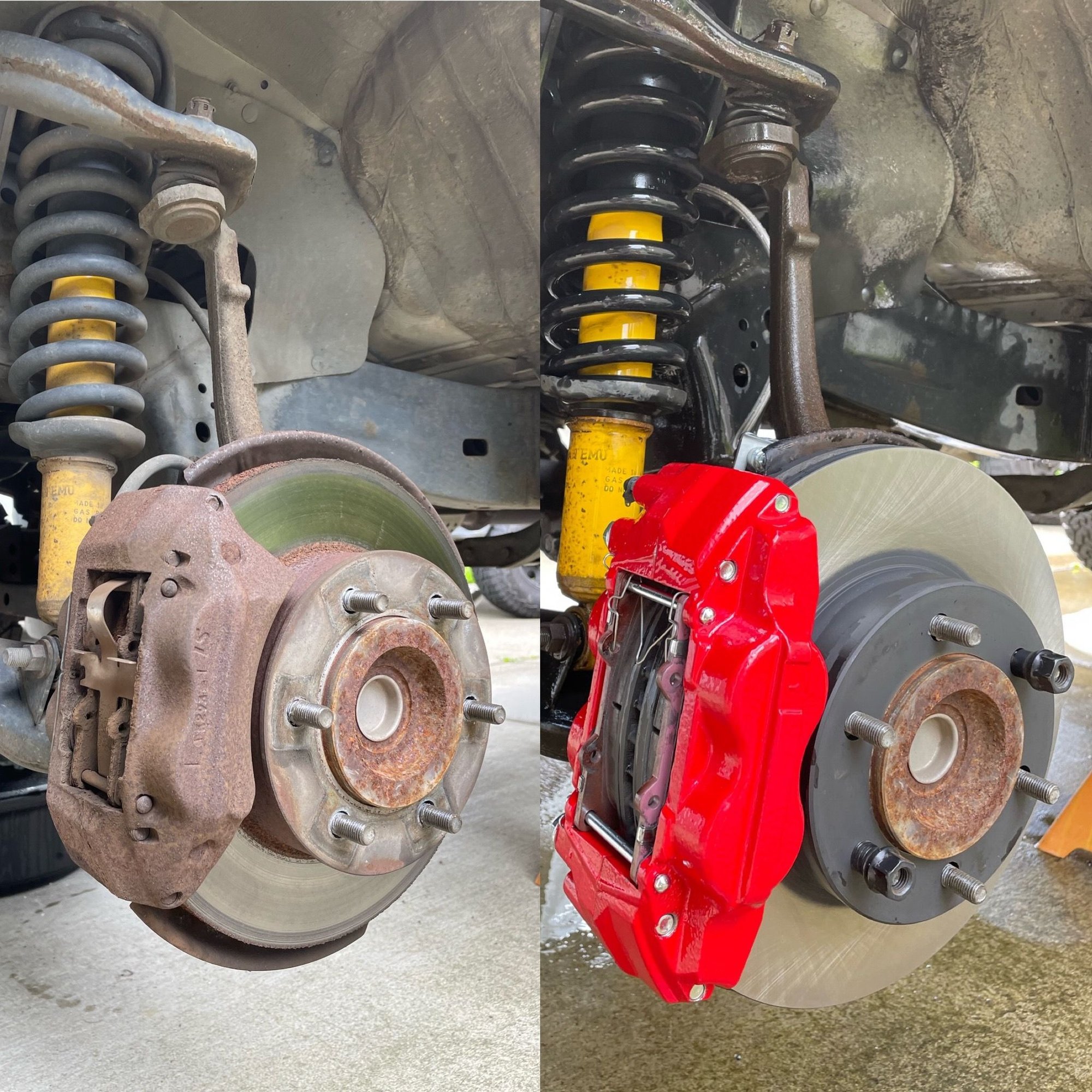

Way back I went even bigger with T100 calipers and rotors. I posted it on Marlin Crawler forum. I'll see if I can find it. It made a big difference but even more noticeable was a dual diaphragm booster from a 2nd gen 4Runner. (Maybe V6 pickups too) This was all on my 88 standard cab 22RE 4x4 IFS pickup at the time. I'll see if I can dig up the links.

Here's the T100 thread. https://board.marlincrawler.com/index.php?topic=77523.0

The brake booster was from a early 90's 4Runner or pickup with the 3.0 V6. A bolt in deal. I used the same master cylinder which I believe is the same as the one Millball mentioned. Going from a single diaphragm booster to the dual was night and day difference.
The T100 calipers cleared the chrome modular 15" steel wheels I had back then. Not sure about the wheels you're running. Something you need to check whenever going to larger brakes.
