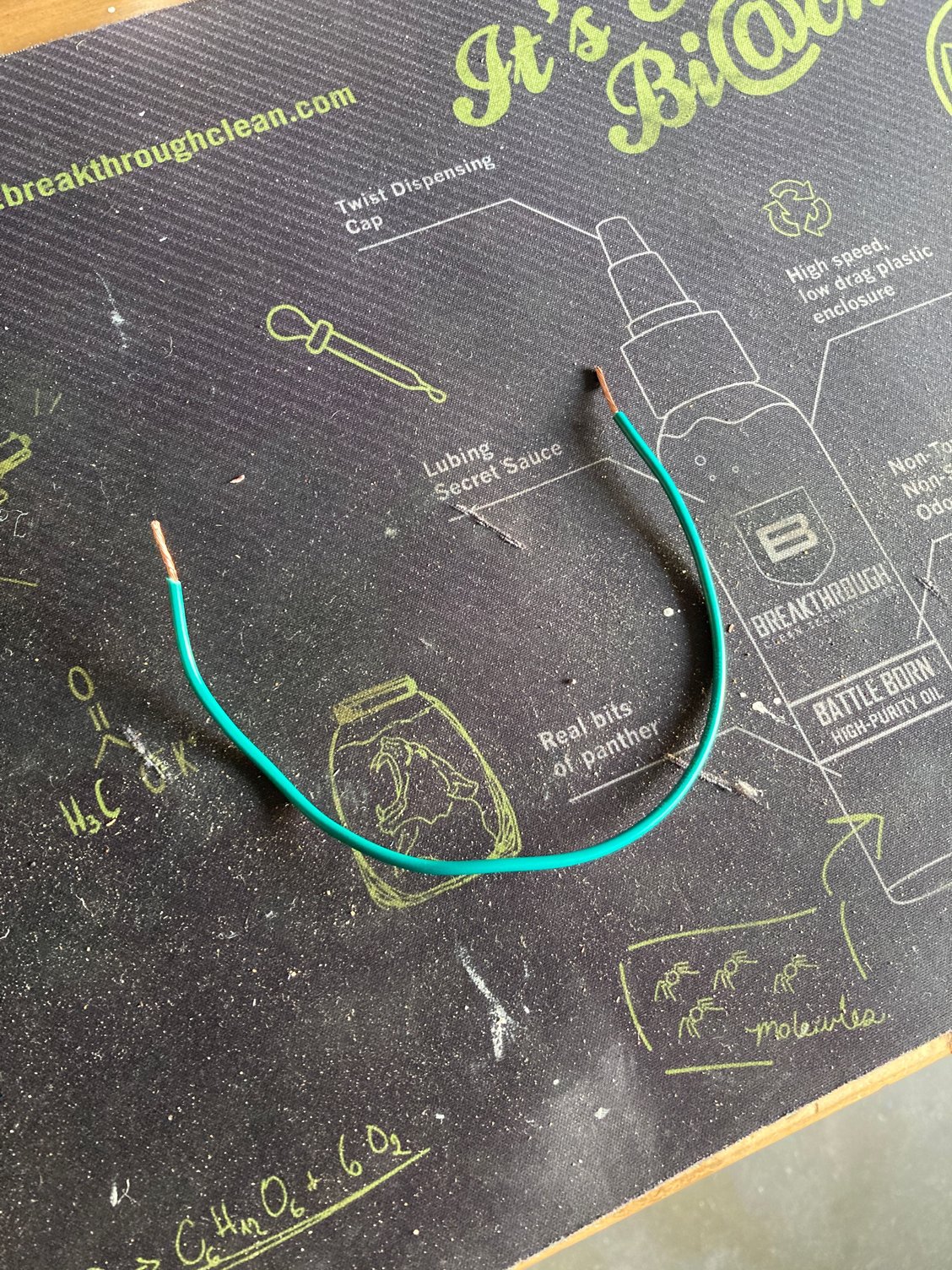

Check the section for the EFI system. The how-to starts on page FI-22. The code numbers and their meanings are on pages FI-25, etc.
Does that help? you'll need the super special; test jumper. VERY pricey item. Might cost a whole 1/2 cent for the paper clip. I made one with a 1/4 male spade terminal at both ends, and about 3 inches wire in between. Very easy.

Thanks I found it in the manual. Also I think I must have the fancy tool for this

I see you went for the really pricey test jumper. Good, good. You get what you pay for after all...
