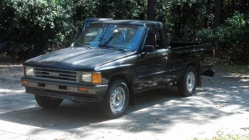

So I finally found some OEM Mud Flaps for my 88. Gosh they were hard to find.
