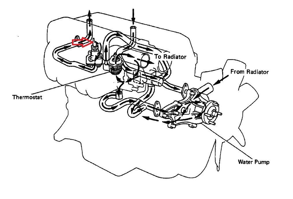

Hi. You wrote that it is located near the thermostat housing and that I should just follow the single wire and I'll find it. I see lots of wires in that area and I gave up after an hour. I'm afraid that in many cases, words are meaningless to me, and I need a picture. It seems as if nowhere on the internet is anybody willing to show a picture of the location you describe. Are you able to help with that? Thanks.

Not exactly a "picture". More of a "diagram", but I hope it helps. This is a diagram of part of the water system. The red arrow points to the location of the sensor for the gauge. Does this help you at all?
Remember, no sealants or teflon tape in the sensor. That will mess the gauge's readings all up. When you pull the old sensor, a brass wire brush to clean the threads is a very good idea. Do NOT use a steel one. Aluminum threads will be destroyed by a steel brush. Only brass or Nylon bristles. It doesn't take very much corrosion on the threads to affect the reading of the gauge badly.
Is this any help?
