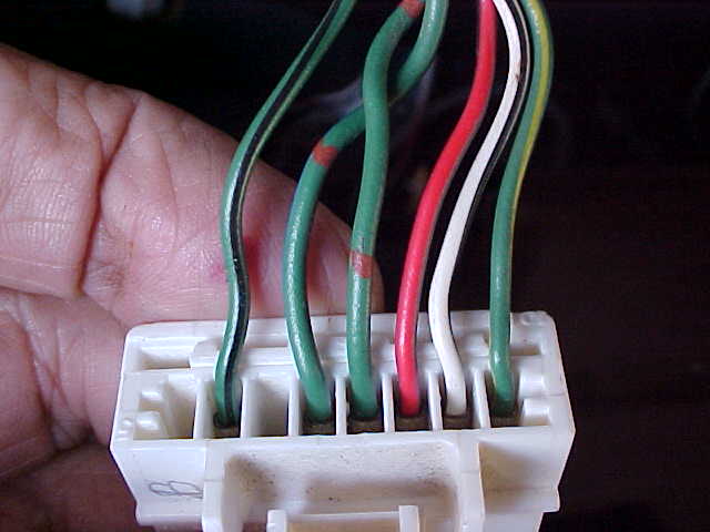

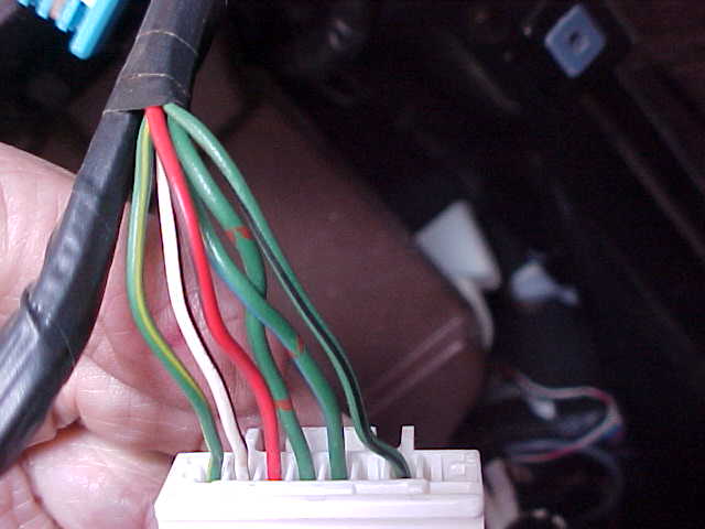

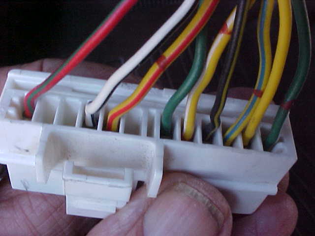

I just completed putting the 87 SR5 ect panel in my 86 non ect Camper,both vehicles are automatic. I read alot of info on here but it seems there more than a few differences between these gauge panels depending on year and trans type and it does take alot of head scratching to get one sorted out so on the idea that a picture is worth a thousand words i thought i would post pictures of the wire positions in the connector plugs before and after in the hope it will simplify it for someone else.this will be my first try at posting pictures so hope for the best. the first 3 will be the plug connectors before any changes 86 truck,the second 3 will be the wire positions that it needed for everything to work. Don
Attached Thumbnails 87 SR5 gauge panel in 86 Toy camper-mvc-029s.jpg   87 SR5 gauge panel in 86 Toy camper-mvc-030s.jpg   87 SR5 gauge panel in 86 Toy camper-mvc-031s.jpg

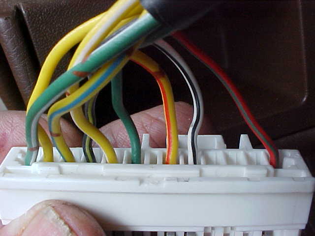

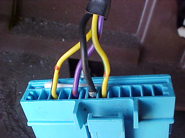

87SR5 panel 86 camper
System only allowed 3 pictures so here are the ones with the wires where they needed to be for everything to work. OH OH i just noticed that i didnt hold the plugs the same way in both sets of pictures so look VERY closely at the plugs position before you make changes,the first 3 pictures are with the top of the plugs facing you and the second 3 with the bottom of the plug facing you. BE CAREFUL. Also note no changes on the 8 pin plug. Don
Attached Thumbnails 87 SR5 gauge panel in 86 Toy camper-mvc-014s.jpg   87 SR5 gauge panel in 86 Toy camper-mvc-015s.jpg   87 SR5 gauge panel in 86 Toy camper-mvc-016s.jpg
