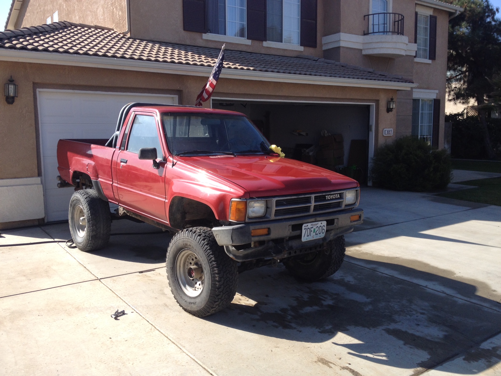

Hi all,
So I am new to the forum, and as a new member i apologize for being the douche that contributes nothing and asks everything.
Anywhoo, I stumbled across a 1987 toyota truck today, and immediately fell in love. Ive always wanted one of these. Some info about it: 160,000 miles on it when it threw a rod and blasted holes in both sides of the engine block (you can see strait through it). hasn't run since february. so the engine is shot. however, the seller is quite the motorhead. he has (claimed to have) replaced most of the major components under the hood (minus transmission), new brakes/rotors, 4x4 works, and the body is rust free. he said quite optimistically that if you drop a new engine in, the thing will be good to go.
the interior is pretty awful. the seats have springs coming out of them. the dash is cracked in multiple places. theres a gap between the transmission and floorboard in which you can see the ground. but he claims the only electrical component that doesnt work is the horn.
now.... following that terrible explanation of the truck.... i have never thought about doing this before. i am in no way a motorhead. none-the-less I've always wanted to do something like this. I have the money and should have the time. I'm not planning on forging my own way.... i have access to a auto hobby shop and already have contacts that would help with the engine.
now, the nitty gritty. he is selling it for $800. I think this is quite reasonable. my plan would be to either buy a medium-mileage engine ($1000?) and swap it, or a heavy-mileage engine ($600) and rebuild it. I'd like to get it running, then decide whether to sell it or put more $$$ into it.
I will attempt (and likely fail) to post pictures of the thing. But please, all you crusty forum veterans out there... help me out here. any comments on the price, engine, etc. would be appreciated

If its not a "rust bucket" then I would go for it if you like it and have the time to give her the TLC she really needs.
One red flag I saw in the original post mentioning about how the previous owner had claimed to have replaced everything under the hood... well... maybe that's what happened to the engine.
But alas we can only speculate.
Price seems pretty reasonable considering the state of the truck... you might can guilt trip him and haggle down some by mentioning the cost of the engine and the various cosmetic issues.... but 800$ seems reasonable.
There are lots of sources to get a 22r engine. Toyota made so many.. they are very easy to find... more or less preference on what your willing to spend on the engine...

I guess it all depends on just what you want to do.
I think the price is to high for a truck with a hole through the block case in point last two I bought I paid less then that for running vehicles I drove home.
Hard to say if the parts that were said to be replaced were and with what brand parts.
It will be a labor of love I wish you good luck any vehicle I ever bought with the notion to resell I was lucky if I only lost a few hundred dollars in the end.

I don't think it's that good of a deal to be honest.
I recently purchased a 91, 216k miles with a running engine and a medium interior.. $1400. I then joined this forum, asked a lot of questions and by the time I was done getting the heads out for rebuild I decided to rebuild the whole engine. Just got a call today the engine is ready.. $1500. By the time i'm done with installing the engine i would have spent $3600 (including purchase price).. and another few months that would come to $4200. But, I will be getting a truck with remanufactured engine, nearly all components under the hood will be new, and interior will be good.
Just thought to give you my quick story for comparison. It is a lot of fun though, and always everything ends up being more work than it looks. lol

The biggest thing you need to weigh is if the frame and body of this truck are worth the asking price. It's a second generation pickup (my fav), but is that the style you want?
There are lots of resources on the net for changing your engine and it's always a learning process, but if you want to learn how to do this yourself then go for it. As for the engine..you already stated your choices, do lots of research and find the best fit for you!

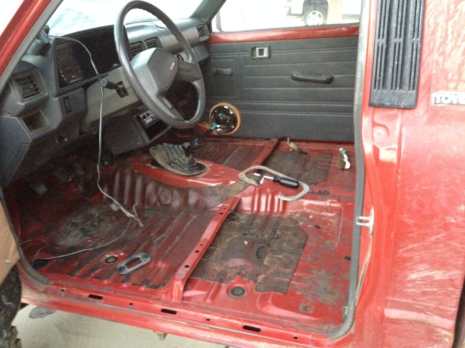

question.... when i pulled the floor up today, a large amount of the insulation/padding underneath the mats is stuck to the body. i tried using a wirebrush but it wasnt doing to great of a job. any recommendations? a strong degreaser or something?

I have used every thing from a air gasket scraper to air hammer with a very wide flat chisel to remove the under coating .
I have tried spray on gasket remover .
I think the air hammer with wide chisel was the best.

dry ice, a hammer and a chisel. Its a tar like sound deadening maternal that was glued to the floor at the factory.

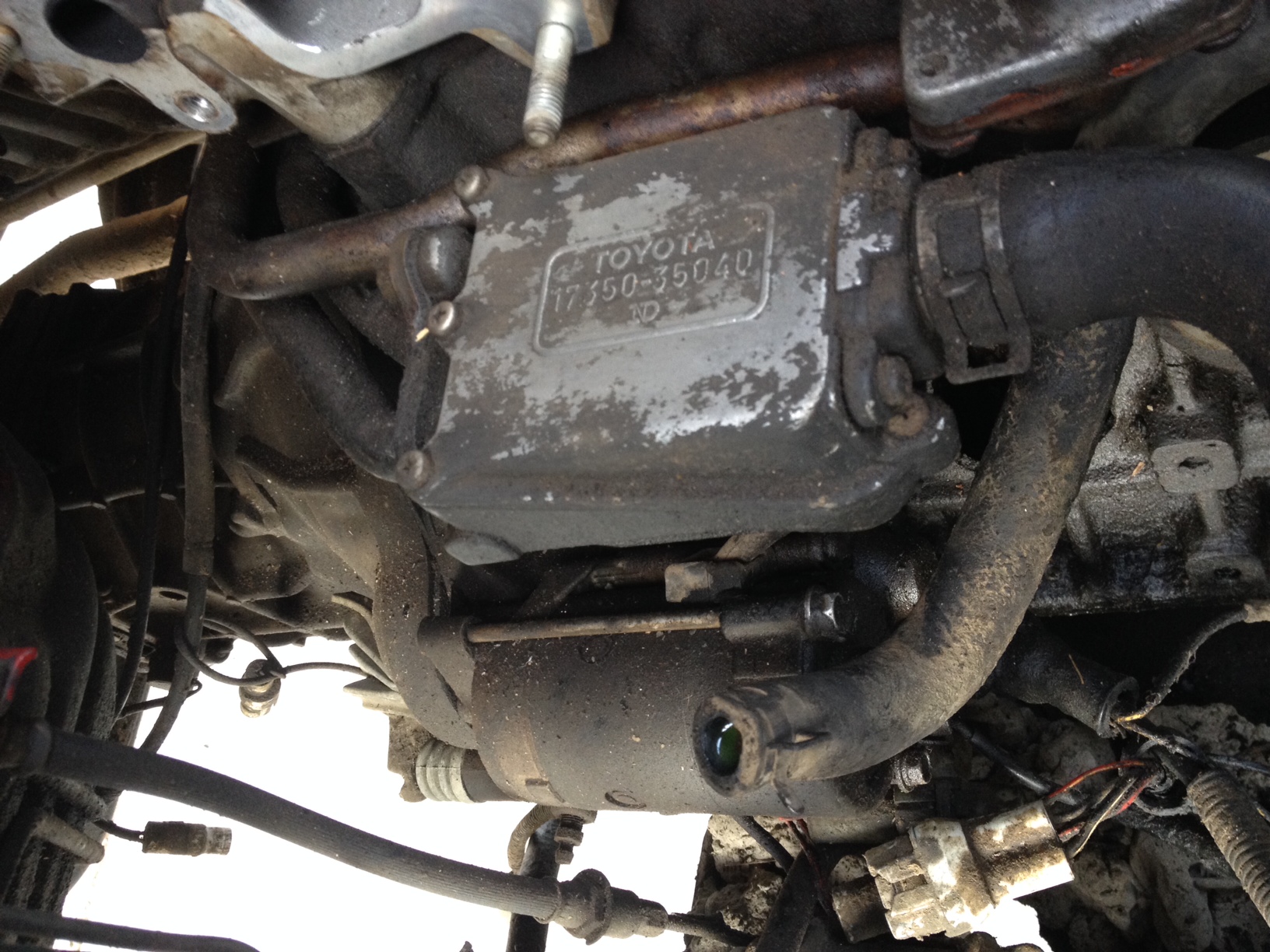

its been a long time since an update. its too late to write a small novel on everthing ive done but im in the engine breakdown right now and need your help. can someone tell me what these two things are below the intake manifold alongside the block? i cant seem to figure them out. id appreciate the help. other pic is of the exterior. the red beams after a paint restoration kit. couldnt be happier with how it turned out
