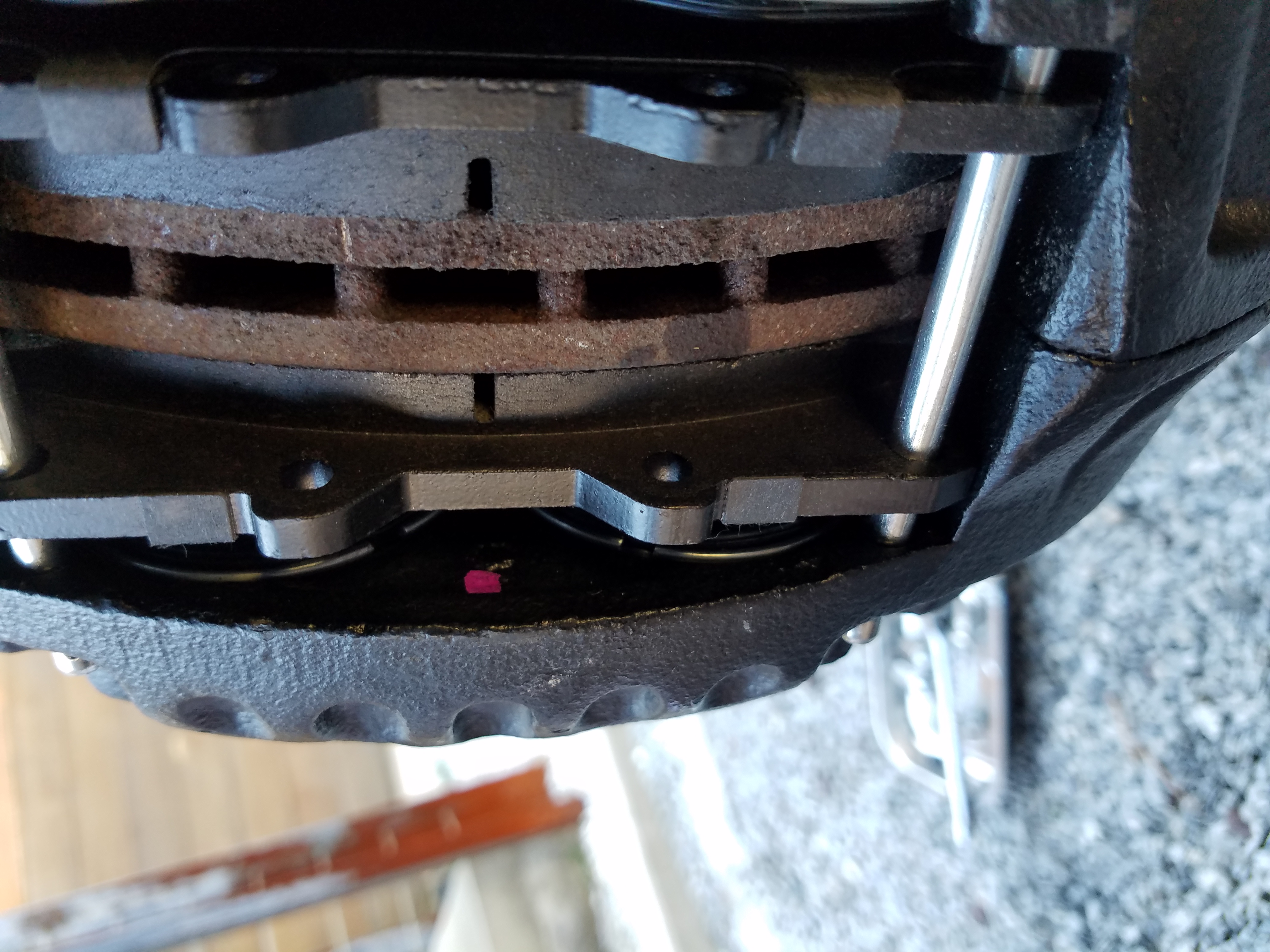

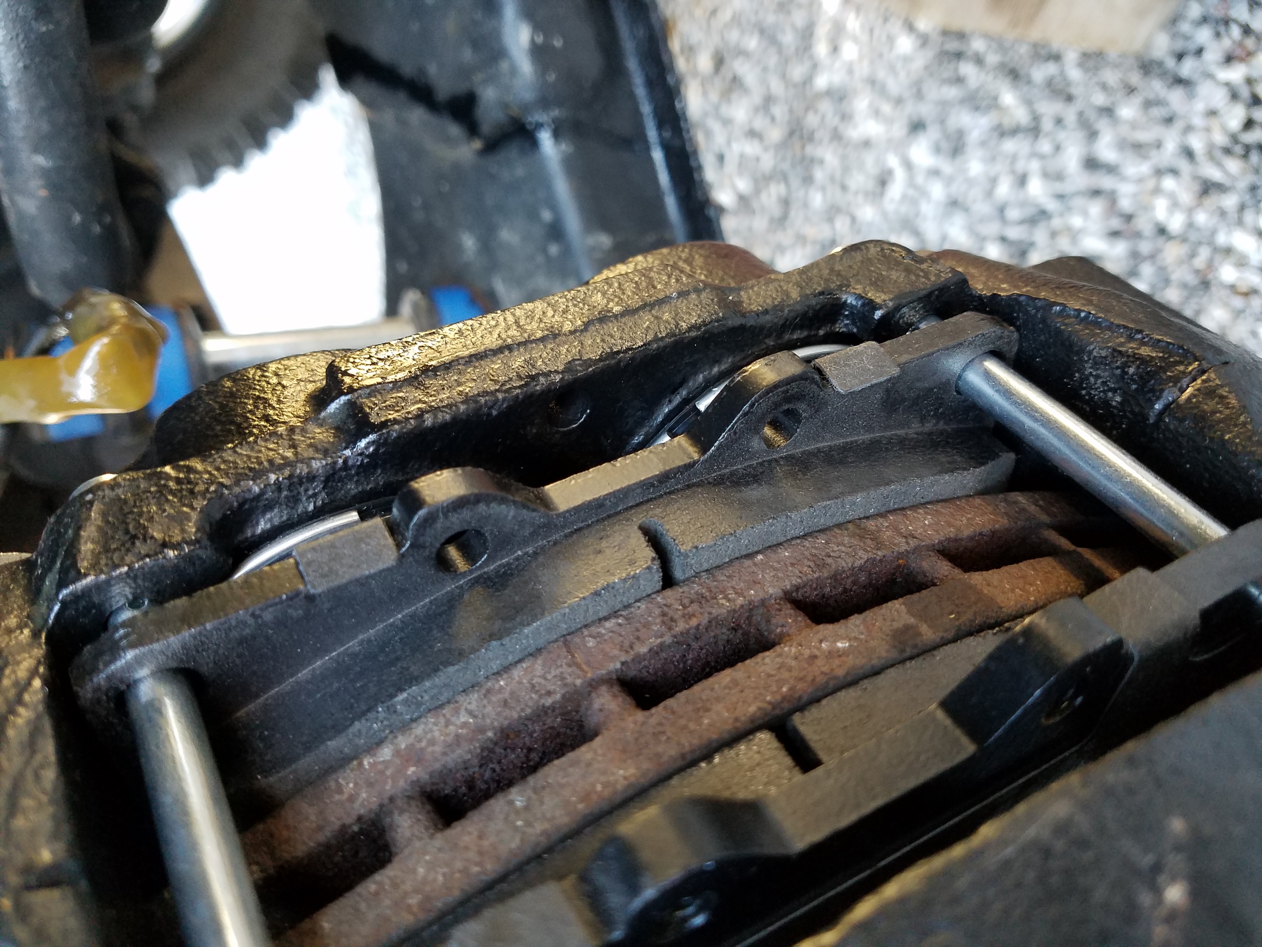

here is a pic - the outer pad looks fine, but the inner pad is about 1/8 of an inch larger than the rotor, but think it should cover completely

you've got a mismatched set of pads. simple as that. one pad is for a different application.

they are brand new out of the plastic. are the driver and passenger side different? didn't think that they were - they looked the same

mismatched, or poorly produced. the lining on one pad is nearly flush with the edge of the plate, while the other has a clear gap between the edge of the lining and edge of the plate. they should be the same.

Just what brand of brake pads are those ??
quality control is a foreign concept in China
Just because they are new out of the box does not mean they are correct

thanks all. i'll swap everything out and then see how the other side looks. i'll post back if all works out (hopefully it's as you note - poor qc so a new set would sort it out)
