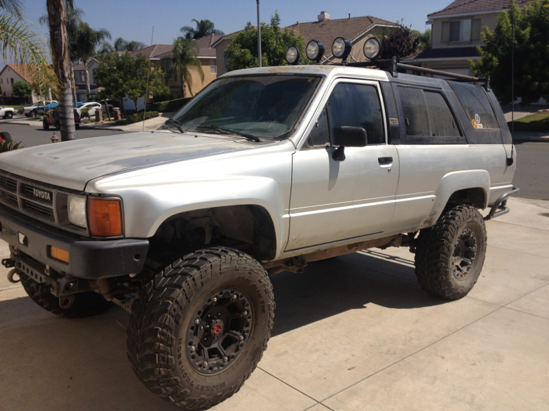

Here is my 87 4Runner "Bueller" as the family named it. on 33's 4.88 gears , 3" body lift with a Lockrite locker in the rear and a few other goodies.
Even with just the body lift it's a pretty capable machine but would like to get a little more out of it.
I do some pretty good wheeling and use it for hunting so trying to keep it reliable and to keep from having to wrench on it out in the trail as much as possible.
There have been a couple times on really loose sand/ dirt/ gravel trying to climb but just digging holes instead. I'm trying to decide whether to just put a locker in the front or installing a Truetrac? would like to save the frant end from too much abuse and keep some turning radius up front kinda leaning towrads the Truetrac but figured before I spent the dough I would ask you guys about it. Any info appreciated.
Thanks
