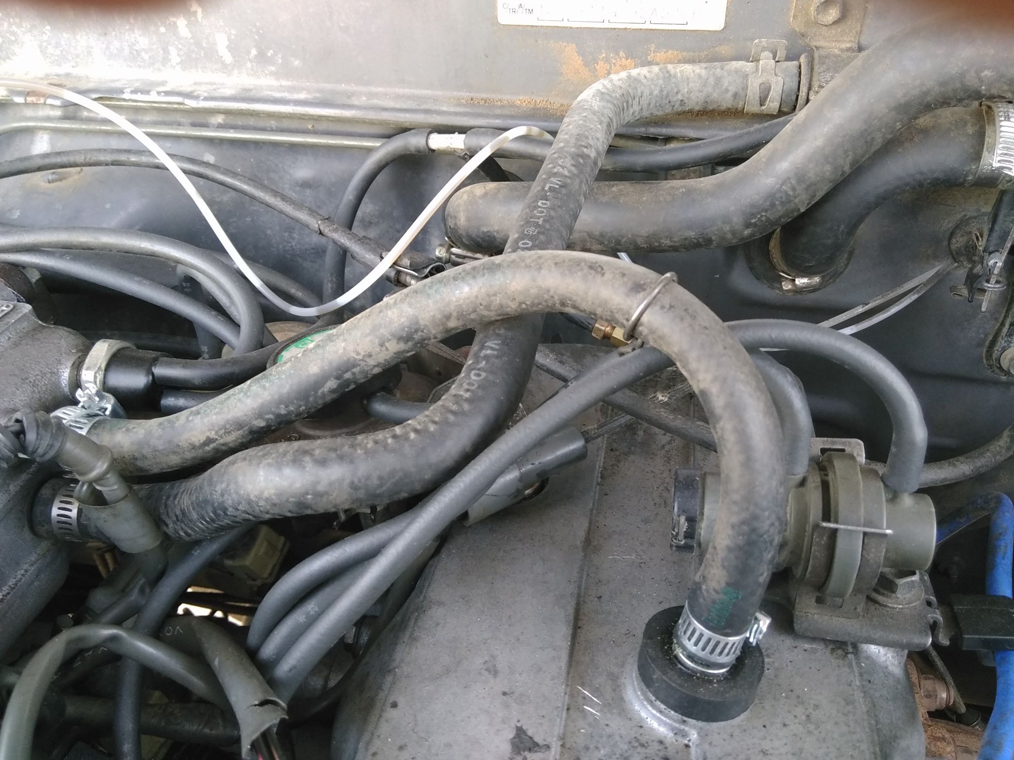

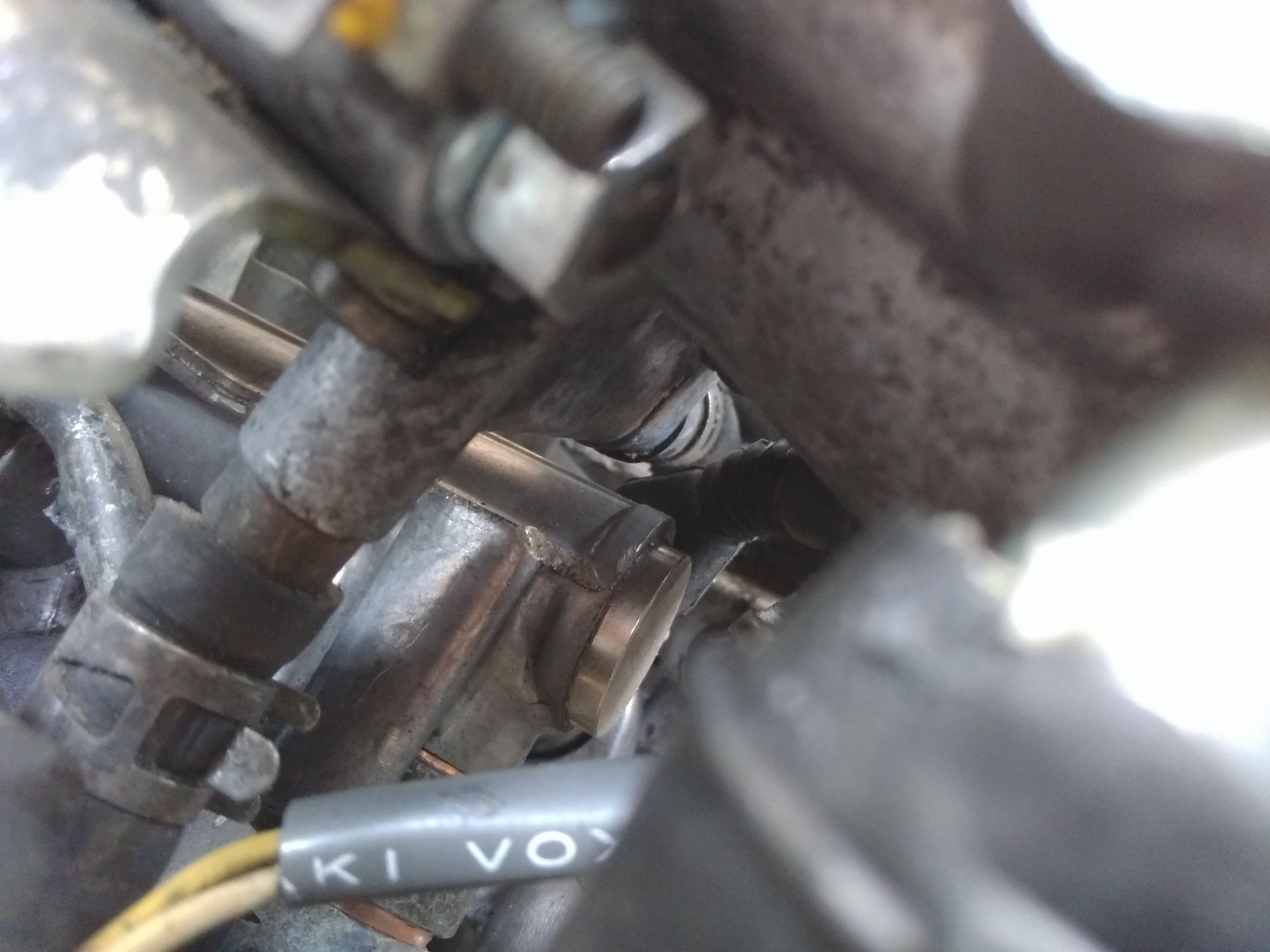

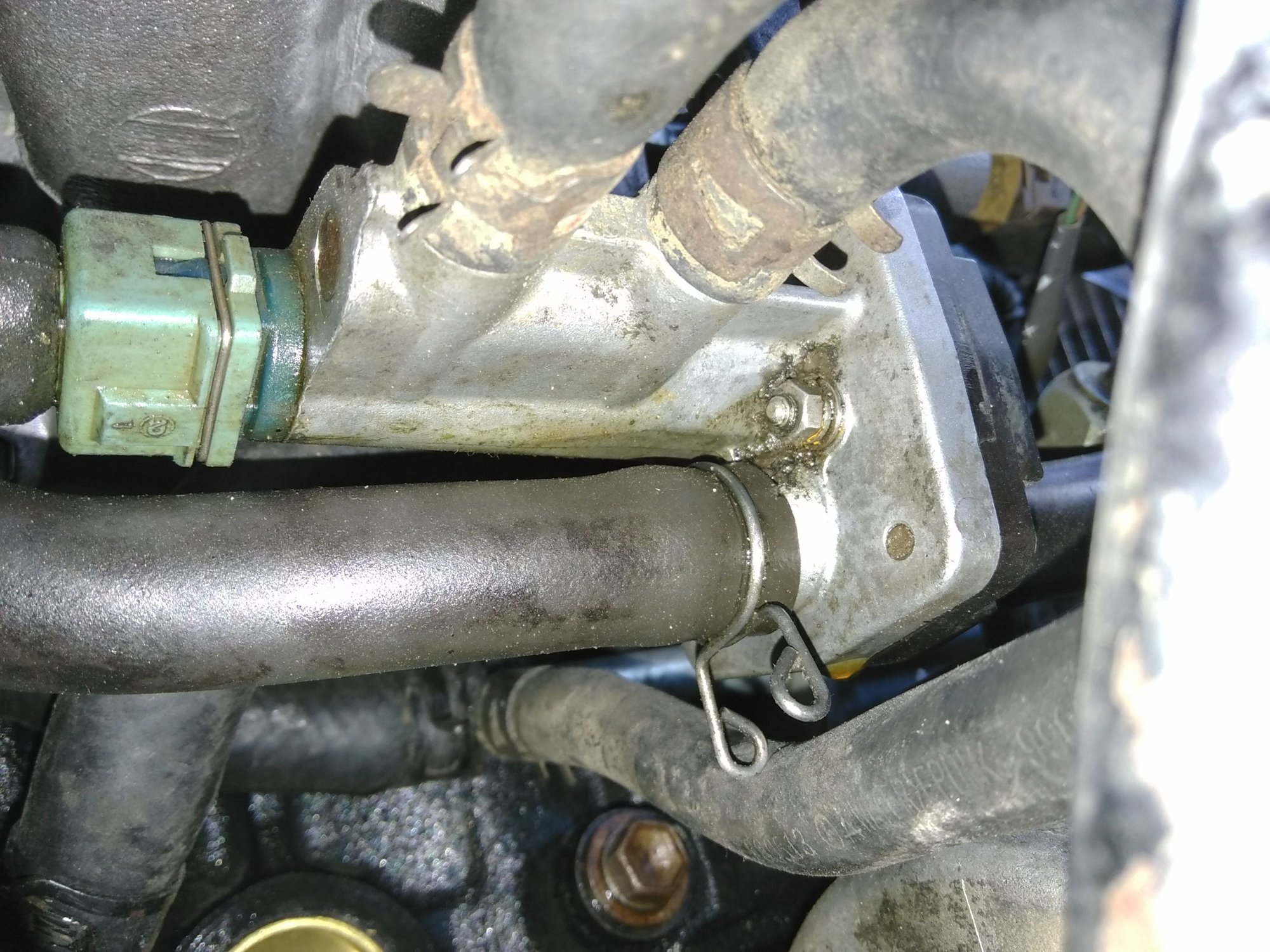

Coolant hose locations
In case it's not clear in this first one the hose that disappeared behind the hex shaped elbow at the upper center of the image attaches to the elbow it's hiding behind.
Oil cooler, forward hose to elbow, rear hose to pump output.
​​​​​The oil cooler if damaged will mix oil and coolant!
air valve. If damaged may leak coolant into intake.
forward hose loops down and connected to water pump outlet. (Hides a bit behind the intake support)
Rear hose from air valve,loops up to intake bypass chamber. Note the shiny end cap of the fuel rail. Just above the fuel rail is the end of bypass hose #2, which loops around the thermostat housing, it can be seen just below the throttle sensor from above. (The far end of #2 is the vertical one you asked the elbow part number, and is for sure correctly attaches at both ends)
PCV valve and brake booster lines to upper intake chamber. Heater hoses into firewall, not shown is the supply hardline that wraps around the cylinder head and attaches to the middle of the lower intake (below the coldstart, below the dash temp gauge sender)
Not pictured are, the exhaust side hose that supplies the turbo and it's return line. Lol, I'll take that elbow off and snap a photo but you'll have to bribe me with a new silicone elbow to replace the OEM one.. it's easier to pull the whole exhaust and turbocharger than get that sob cracked brittle elbow back on with it in the engine bay.. you have these hooked up correctly, aswell as the crank case vent as seen in the video..

Thank you for the pictures they allowed me to see that i had a breather hose and a coolant line swapped. I also got around to checking out the turbo. the shaft has a little side to side so i think its bad if i remember correctly, The exhaust housing has a crack on it. I have two turbo bust turbos and im hoping to be able to piece one together that will last a little while. I am on a shoestring budget (think like a really poor college age budget) so ill probably call around and see if someone can fix the two housings i have for cheap and try to see if the other shaft with no side to side play, the one that wasn't in the truck, will fit with the housings i just took out of the truck. or if there is a housing that is cheaper than getting one repaired please post it or send it to me in a message or something thanks. like something cheaper than 150$ i found this and i might end up doing the ebay route. its way more than i wanted to spend on an exhaust piece. has anyone bought this piece it looks like everything would line up. Id rather not have to do this for at least another year if i can help it. thanks for looking.
