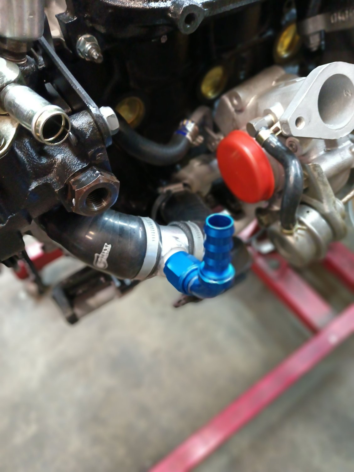

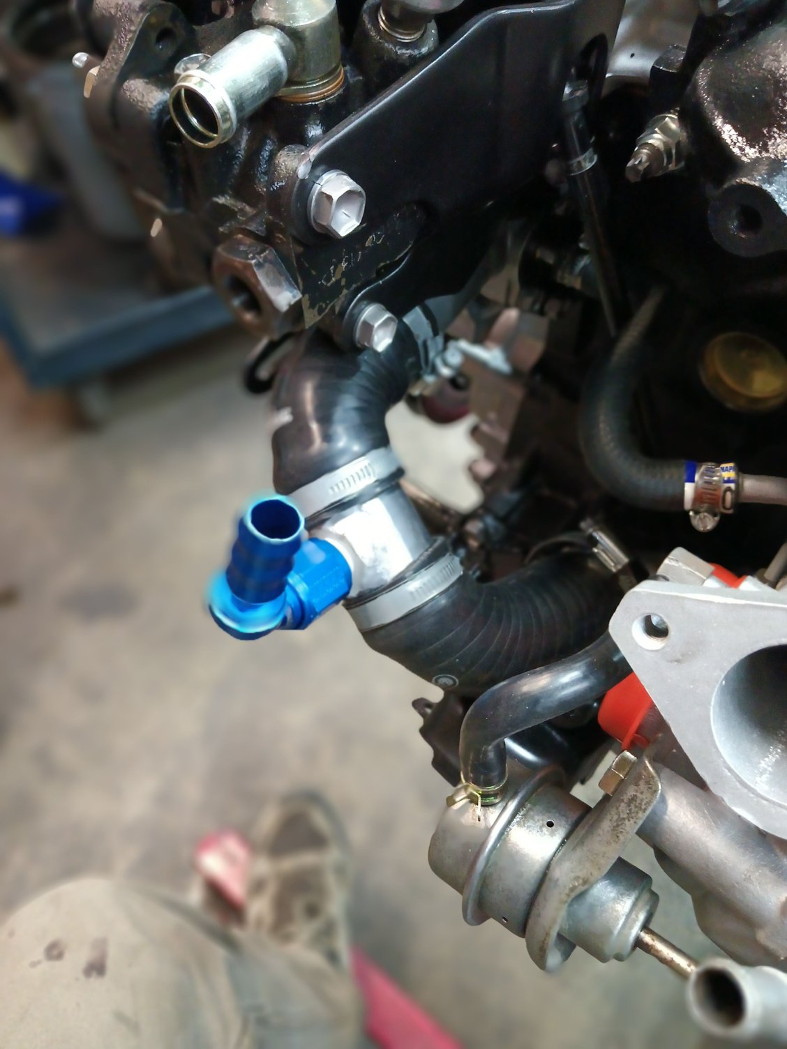

update! sorry it has been quite some time. ended up pulling the engine to do a rebuild at local shop that let me do all the labor. still a lot of little things that need to be done to get her cherry but she runs again! really wish i would have documented it but was in a hurry to get it done. we ended up fabricating a middle section out of aluminum, tig welding a bung on to it and running a AN fitting to the heater hose. the two sides of the "U" shape where made out of some nice silicone hoses. will get some pictures up when i get a chance. looks a little janky but it does the job like a dream

Old Dec 19, 2024 | 04:10 PM

I dunno about janky, that looks a lot more solid than the oem hose. Nice work!

Why thank you kind sir, I was pretty proud of it but the welds are pretty thick. I didn't want any leaks. It's been holding up great and the kids really enjoy having a heater when we putt around.
