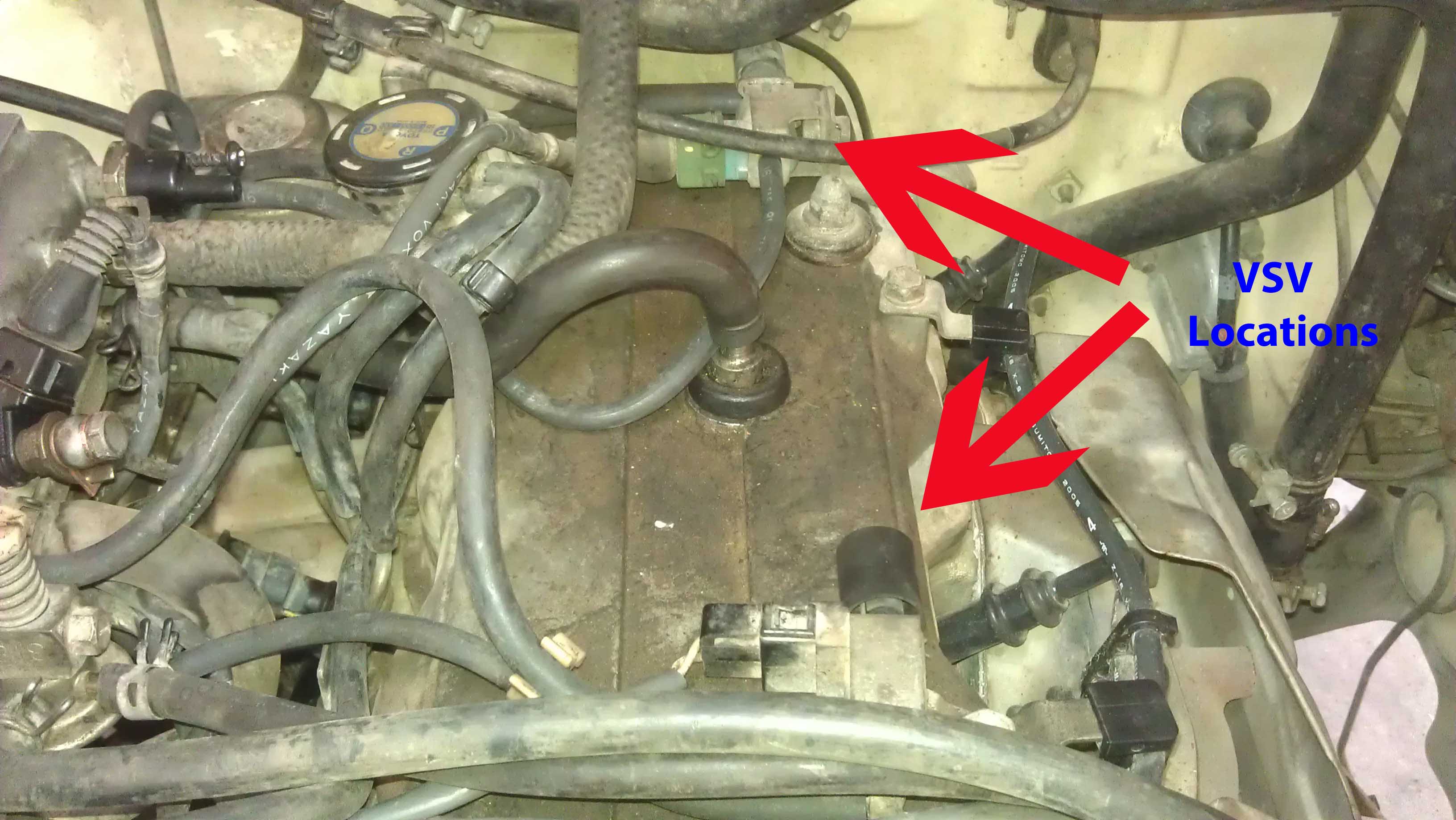

1) I'm missing a vacuum house and the nipple it plugs into is broken, I am posting 2 pics, the first pic shows the location and the second pic shows which nipple is broken. I dont know where this hose goes to. If anyone wants to explain it to me like I've never picked up a wrench because I've looked at many diagrams, even the one under the hood, and can't figure it out.
2) The truck starts only after pumping it and holding the pedal floored and the idle is very rough, it dies out and will not stay started for more than a few seconds unless I'm coaxing it by messing with the throttle. I cleaned out the EGR valve, was a little gunked up, also cleaned up the fuel pressure regulator. I can't figure out how to check the fuel pressure, that's one part. I checked out some threads and a few of them pointed to a bad distributor pick up coil, I posted a pic, can someone please tell me if I did it right, it is my first time checking a pick up coil and I've never used a multimeter either. If I did it right, then the pick up coil is fine and I'm stumped....I can't get my truck to run.......It's my first Toyota and I waited for years to find the right one, I really like this truck and I want to get it running right.

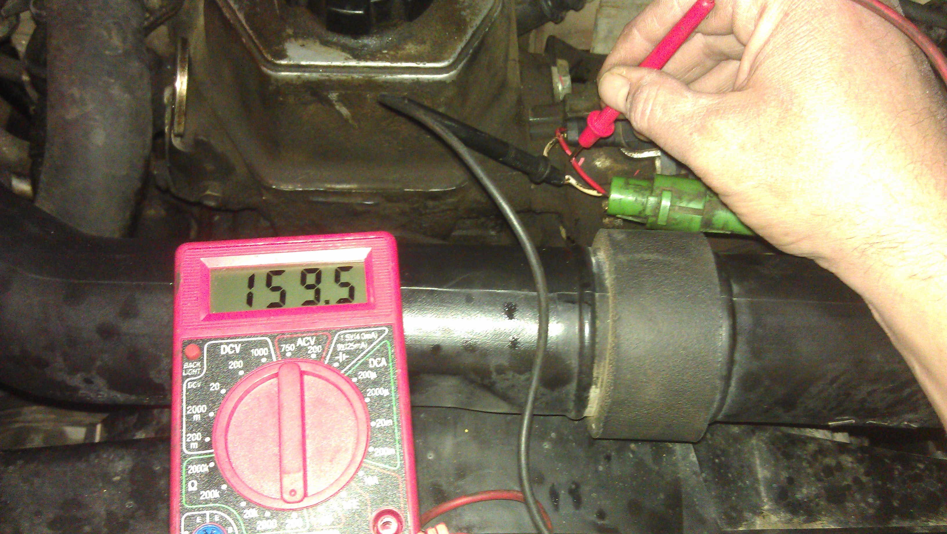

OMG OMG don't cut into your wires! If those holes were already there thats part of your problem, if you did it it's still going to need repaired.
You need a tiny screw driver, "ice" pick, or safety pin, and some heat shrink tubing, plasti-dip, or (ug) electrical tape. To get heat shrink on there you'll need to release the locking tabs in the round connector that hold the metal connecting bits in. Clean the wires really well without using water. heat shrink, spray or (ug) tape over the holes, and reassemble the connectors into the plug plastic.
Now do the test again without the round plastic connector hooked to the rest of the system, by inserting your meter probes into the plug.
Not really sure Why the FSM shows the probes jammed into the back of the plug there since it also shows the plug disconnected, maybe a male spade I guess. You need to pull the rear section off the round plug to do that..

1) I didn't cut the wires, I just stripped a bit off the plastic off, but I repaired open spots in the wires immediately after the test.

But while I do.. How about an overview of the engine bay. I'm kind of interested in the valve cover area with vsv's, and the vac line map on the hood.
Add some light to the pictures, even if you have to snag a table lamp from somewhere they are very grainy and more light usualy fixes that.

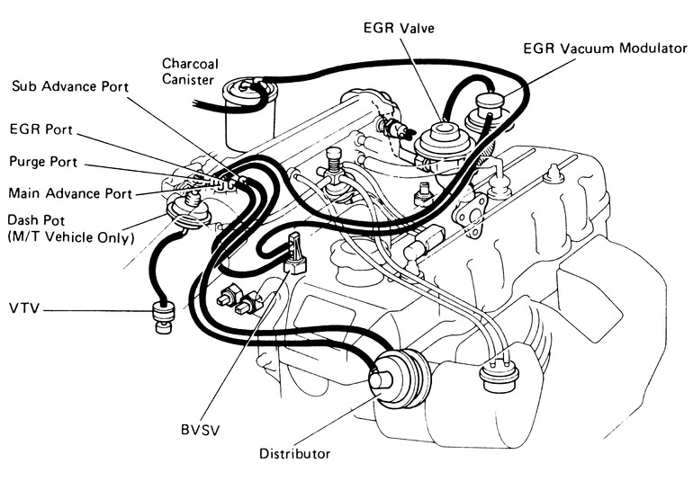

Couldn't find it in the manual I had to resort to google and I turned up picture for an 1984..
it shows the line going out the top to a VSV(?), and back to the bottom of that device.
So uhm yeah put that line back where it was, and I'll take another swing at it once I get to see the hood map
I did find out that hole you pulled the cap off of is there to test the EGR, thats handy I guess. Sure beats applying a vacuum to it via the lip test.

Hey Co_94_PU,
Here are the pics you asked for, an overview of the engine bay and the VSV locations.... The auto parts stores around here want $150 deposit to rent the fuel pressure tester, so that gonna have to wait a few days.

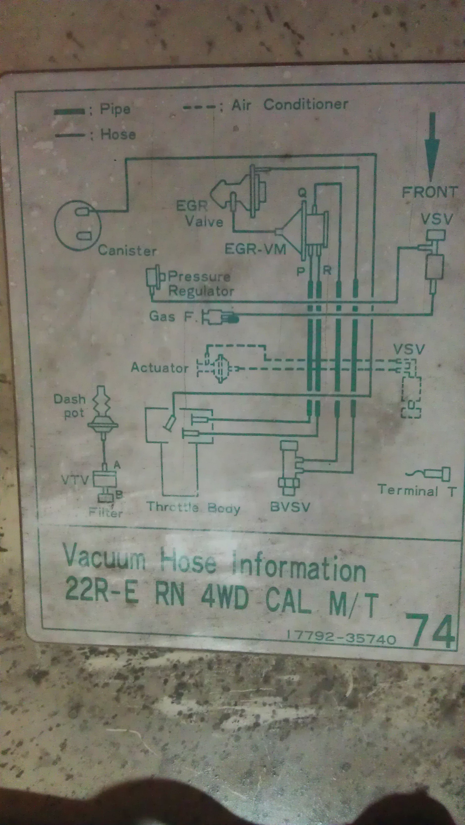

Still missing the vacuum routing map, It's probably in the upper right hand corner of the under side of the hood when it's open. Might be buried in gunk..
The 88 fsm doesn't have 22R-e cali vacuum map, only for a 22r.
Got my mspaint out... This should be a little easier to follow.
Color coded 22re emissions vacuum system diagram attached at the bottom
The closest I could find on autozone's site was (I think) an 1984 22-re(cali)

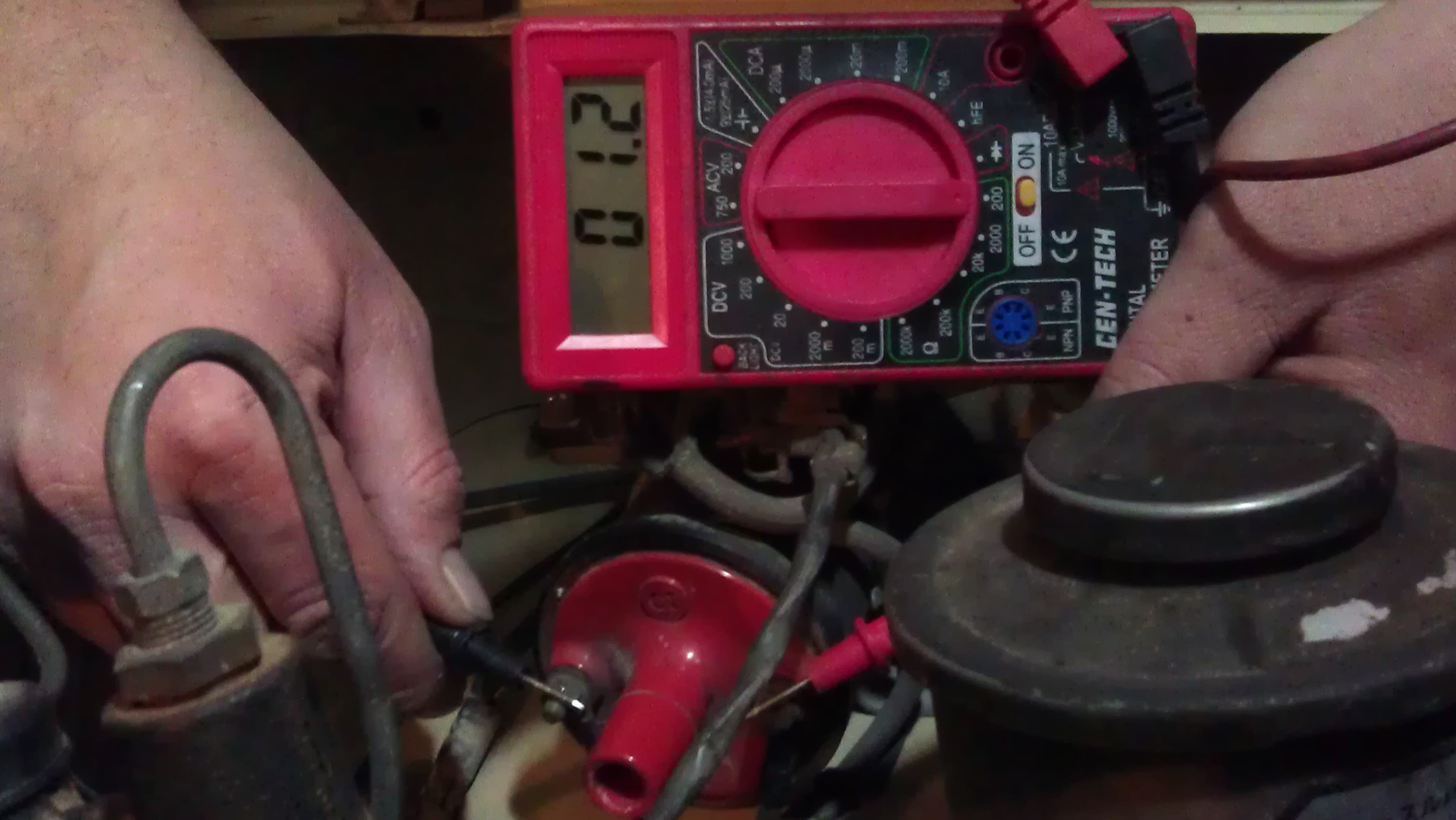

I tested the coil and it came in with the following:
Primary Resistance = 1.2 Ohms - Book says = 0.5-0.7 Ohms
(should the extra Ohms concern me)
Secondary Resistance = 13.08 Ohms - Book says = 11.4-15.6 Ohms
Insulation Resistance = Infinity - Book Says = Infinity

3) I will clean the coil contacts and update
4) I checked the signal generator and it tested good, in my OP it shows a picture of the reading at 159.5 but I didn't check the air gap, I'll buy a feeler gauge tomorrow and check it.

Update
I just cleaned up the coil contacts, unplugged all connectors to the coil except the igniter leads and re-tested, here is the pic with the results. could this be my whole issue?
