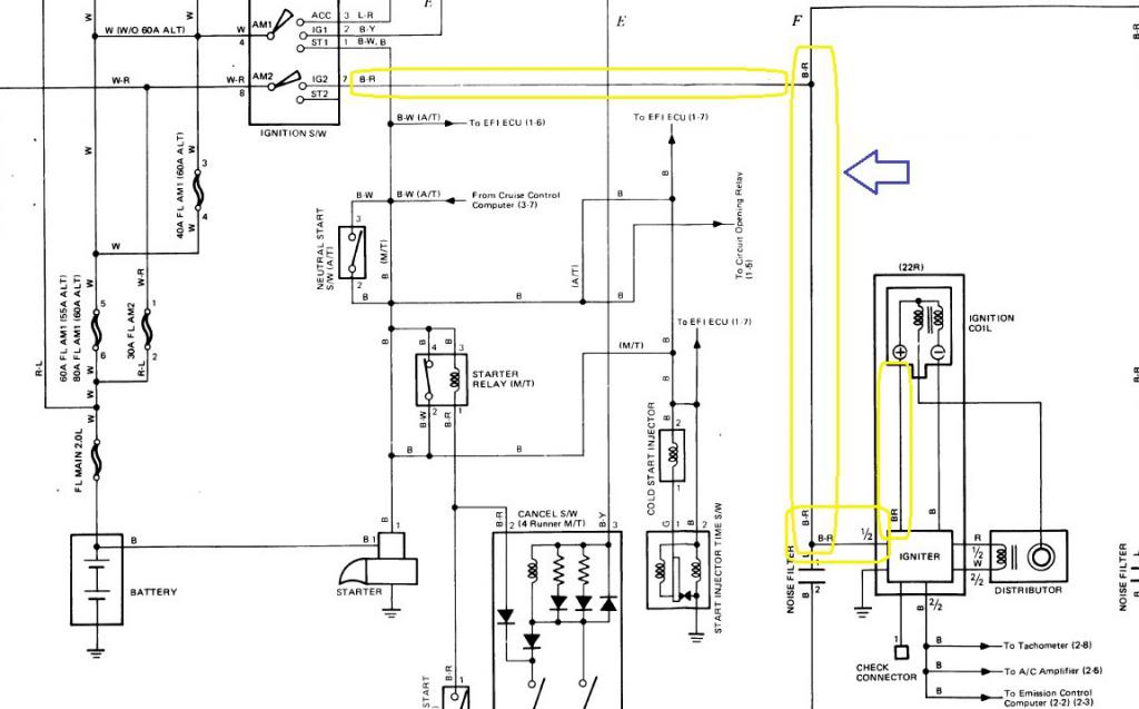

To start, got power to ignition circuit?
Check if you have 12V on Black wire with red stripe (B-R) enclosed in yellow in pic below:
How sure are you that you used good ignition coil?
No spark out of ignition coil (before distributor) or no spark to spark plug?
Checked resistance of your high-voltage ignition wires?
Check resistance of signal generator (pickup coil)? 140-180 ohms
Many more to check...

I couldn't get a spark out of the old coil (got a new one) if I tested it properly. New coil and distributor cap 12v in ign coil.
