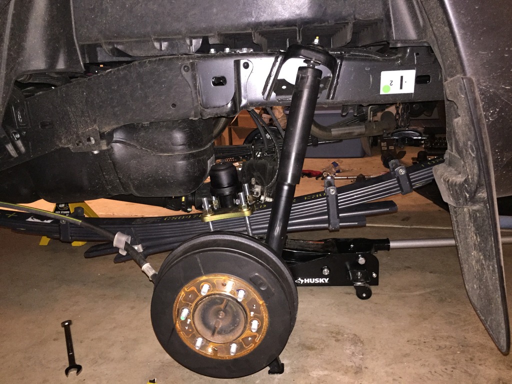

yes, i think you are correc that the right side spring is set up correctly with the overload spring being on the bottom of the spring back.
that being said, Toyota hasn't gotten rear springs right in 4runner's since day one and they all have a saggy butt. They even had a recall for rear springs on my 05 tacoma.
Your springs are pretty much beat, i would recommend replacing them with some like a set of OME (old man EMu)
or you can band aid it and search the Zuk Mod...some people have reported good results on it...tons of threads on it.

here is a pic of an overload spring set up on a newer tacoma
