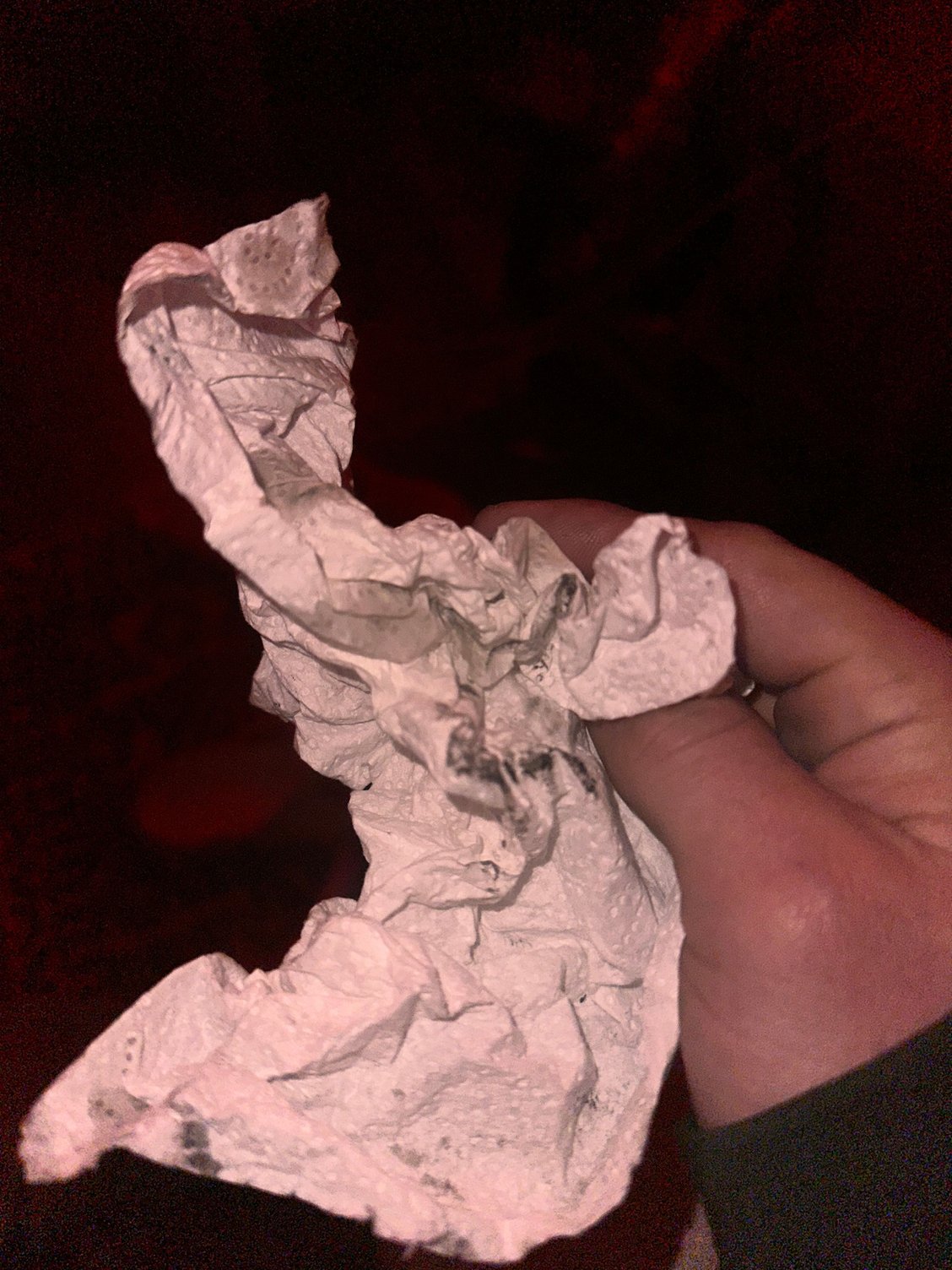

engine oil is at level it looks clean but has metallics in it
Old Dec 23, 2023 | 08:58 PM
86cherry's Avatar
Joined: Jun 2023
Posts: 12
i changed the oil a little over 100 miles and then ive driven it another 150 so probably gettin close to 300 miles. this is whats coming off of the dipstick when i just checked it
