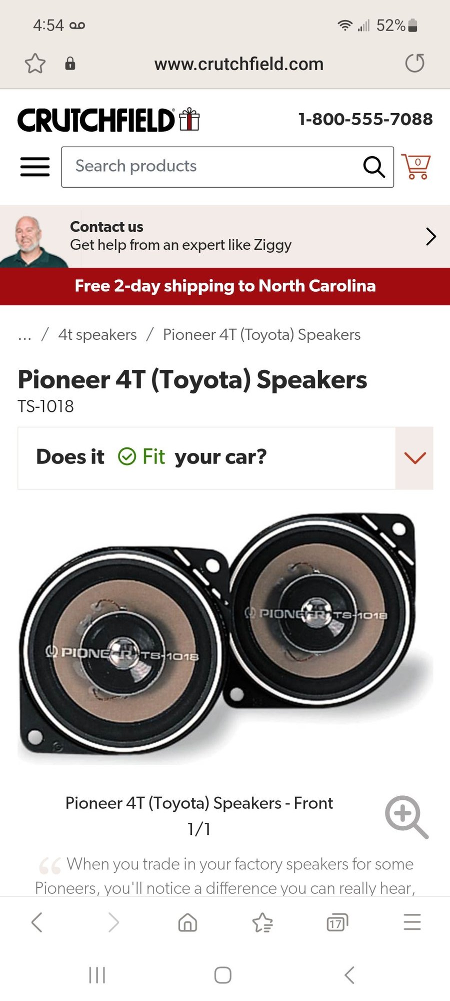

I do remember the front speakers being a 4T which were a direct bolt in. Don't think those are available in the aftermarket anymore so folks have had to adapt when replacing. On my 94 extra cab the front speakers are actually mounted in a small enclosure. I replaced them years ago due to dry rot of the paper/foam surround with some pioneer versions at the time.
Not much help on the rears but if I remember correctly they were different than the front speakers and use 4 mounting tabs vs the fronts using 2 tabs.
These were the front type speakers

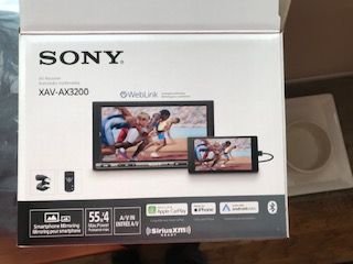

ok, here's the unit I got. Sony XAV-AX3200
It comes with a pigtail harness that you can use to splice into your existing wiring. but since I repaired my loom and have the connectors I wanted something cleaner. Fortunately getting the adapter harness that fit the 1987 was pretty easy.
With the radio faceplate being double din, but the main body a single din, it freed up some room within the dash. that made it easier to deal with that bundle of wiring.
The Toyota radio brackets fit fine-no issue. installed in the slot like any other unit.
But here's the one issue that maybe made Crutchfield say it wouldn't fit. It does stick out beyond the trim by about 1/4". (the Panasonic was perfectly flush)
It's not much, and many wouldn't even notice unless they knew otherwise. I'm pretty picky (ok fine, very picky) and i'm ok with it.
It's a ton easier to use than the Panasonic I pulled out. The Sony screen is very easy to read, not busy, and self explanatory. I didn't need to grab a manual just to set the date and clock.
If I could change one thing it would be the usb port. I'd like it to be with the radio. This one is on a 3ft cable that allows me to route anywhere. i guess I'll run it inside the center console box under the armrest, though i hate drilling a big hole into the box.
I got a back-up camera (the radio has a port just for a camera). It's designed to be powered off the reverse light circuit so it comes on when you shift into reverse. That installed easily, and I was able to route the wire without drilling a hole through the door. The black plastic trim on the tailgate with the "TOYOTA" logo has a center stud on a bracket. If you unscrew that bracket from the trim and remove there's a hole big enough to pass the cable through.
