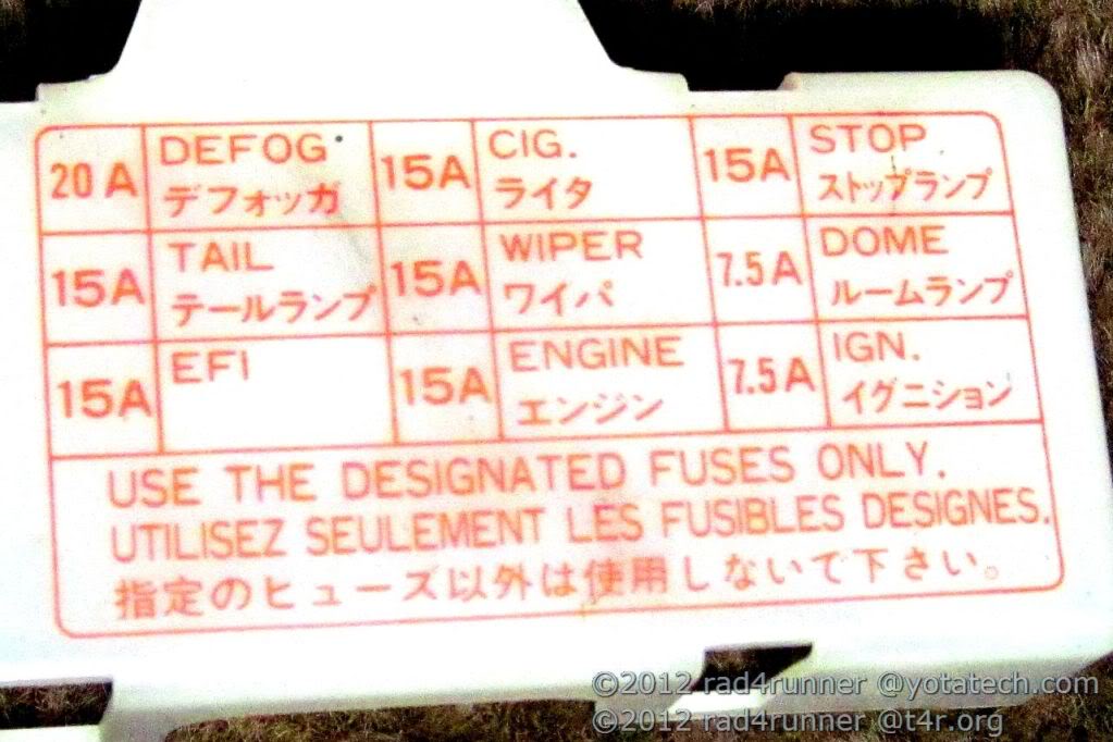

Fuse Block:
In left kick panel. Illustration below. EFI relay is to right of black relay.
Fuse chart is here:

Can anyone snap a pic of the under good fuse box? I need to relabel what mine are for future reference. I'd take a shot in the dark and say yes, it's the stock original fuel pump. Dash shows 112,000 miles, but no telling how long the things been twin cased, but it also may have been a crawler since then getting almost no miles on it. That's also saying it's 112,000 for sure.
