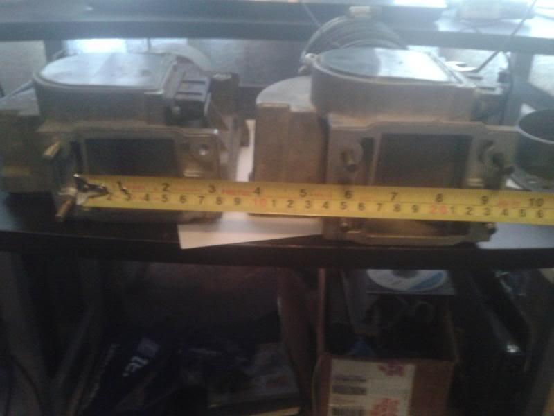

82 supra MAF pic?
No I have read in multiple post and such that an 82 supra has the afm or maf whatever one it's considered, swaps out and provides a larger airway for the 22re motors. But the 82 is supposed to bolt right up and work fine.
Yeah, that's the one I'm talking about. I probably wrote in half the threads you're referring to because I've done it. You're looking for a 86-92 Toyota Supra with the 7MGE motor. That's the one with the larger VAFM, also similar year Cressidas with the 7MGE and possibly 92-93 3VZ-FE Toyota Camry's (unconfirmed). However, the Supra has the airbox that you can keep as well that fits in the engine bay better.
It's not quite plug and play, unless you've already changed your air intake boot to fit it. There's no permanent mods but since it's bigger, it's not going to fit in your old air box or the old air intake boot. You're going to want to increase your intake hosing/piping size to 3" to benefit from the larger opening.
Also, I'm unsure how it fits in the 22RE engine bay. All the pictures and threads have been for the 3VZ-E. I'd look into it more, see if it's been done successfully on a 22RE and what intake piping they made/bought that fit right.
No I'm talking about finding an 82 supra with the MAF and apparently it's pretty much plug and play. Part number 22250-43110. It is what guys on these forum a say goes right to the 22re and most that I've read have done it are like 86-89 Yotas like mine. U can search 82 supra MAF swap and see what I'm talking about.
here is the part number if it helps: 22250-43110 '82 supra afm
It sounds like it makes sense. Is '82 the only year that works in a 22RE??

It's plug and play as far as the MAF cable goes, but you do need to alter the intake hose size to fit the larger MAF, and also fit your intake manifold still. AND, as mentioned, it doesn't bolt onto your stock airbox, so you'll need to get an exposed filter element and perhaps an adapter to make that fit.

I just picked up a Cardone reman 5MGE 1982 Supra AFM P/N: 74-20028 from ebay for my 22re. It looks pretty clean inside and got fresh black paint all around. Flapper spring seems pretty smooth with slight noise from the spring. The connector has 7 pins (two look new) and the opening is ~3in. Odd thing is that the black cover is from NipponDenso 22250-35020 from a 22RE.

there are two different type of AFMs used for 22REs. The older 22RE uses a square topped AFM, but there are newer AFMs that have rounded plastic covers. Ensure that you purchase the AFM for a Cressida or Supra that replicates the same shape as your 22RE AFM. For example PajamaWally's picture has two AFMs that have a curved cover for both AFMs. However, Blackula has AFMs that have square plastic covers - suggesting his 22RE is the older version.

Update on install:
2.75" to 3" elbow reducer, 3" aluminum pipe, 3" coupler, 1982 Supra AFM, Universal adapter, Cone Filter
Removed EFI fuse for 10min
The Cardone Reman AFM worked pretty well! Since my 85 has the TB that faces down, it was a pain in the butt to get all the plumbing. I had to cut some of the fan shroud off since I have a larger radiator. Overall it wasn't too difficult, just need to wiggle things around to make sure things have clearance around it.
