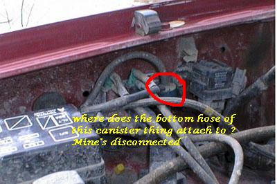

Found a loose hose coming from the bottom of the little canister looking thing on the firewall side of the VSV assembly. Can't see anything obvious it could attach to. It's not sucking or blowing either in 2WD or 4WD.
Here's a pic
Here's a pic
Attachment 67305
That piece you circled is your VSV for the ADD system.
