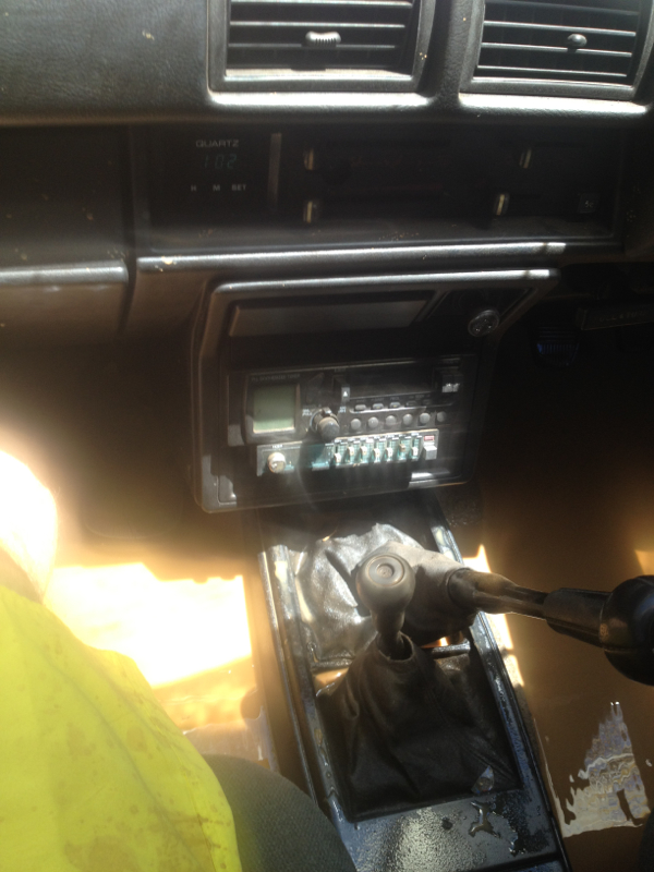

I will add more soon. Got one from after we started to reverse then got stuck. Who: brother in law.
I got the truck 2 weeks ago. Why can't I have nice things!
