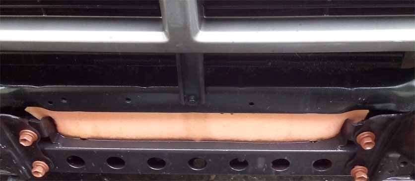

Hey Cory Nice work on the Fan Clutch, Someday I'm going to have to do that. As you know I've been putzing around with some many projects I don't know where to begin or end. Rain put a stall to most of my projects. Listen I was cleaning out the garage and came up with some packing foam for a IBM Blade Server board. It had the right size foam to stuff around the radiator. I ended up stuffing between the front bar just below the condenser core. I don't like doing it, cause I am assuming this will retain water longer which in turn may turn into rust. On another note, the foam may also deteriorate quickly because it wasn't made for such exposure. I'll take a snap shot of it since I have the front bumper off it is exposed right now soaking water...

Hey Cory took a shot of that filler foam at the bottom of the condenser. I don't know what this would do to the radiator cooling as the foam takes up a lot of space.
You can see I also cleaned up some of the front end of the truck as well sense i had the bumper off to clean it and paint it. I'll probably paint the bumper a flat or semi gloss black.
