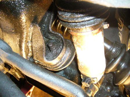

I have a 1990 4runner V6. I've have put about 100K miles on my truck and when I first bought it I hit a large rock with the front drivers side tire. This blew out my shock and when I put new rancho 9000's on it I noticed a dent in the front shock (pic 1)! It appears to be the bump stop hitting it. Also, the front sway bar is rubbing on the upper divers side A-Arm (Pic 2). Is this a frame of a IFS problem? I have had two alignments since and neither of the technicians have noted a problem. Would a IFS truss fix this?

I think those shocks have a tube within a tube. It is the innermost tube where the piston travels up and down. The outer tube houses extra oil and gas. Thus, I don't really see it being a big deal, but correct me if I'm wrong. It would be helpful to know if:
a) your truck tracks straight still?
b) is there any dent on the other side?

No dent on the other side. The tuck tracked straight when I had a new alignment. Good news on the shocks, that would explain why the shocks seem to be fine. I was also concerned about the notch ground down on the sway bar. When the front suspension flexed it would make a horrible squeaking noise and now I want to put it back on trying to fix any problems before I do that. I guess I could just grind it down so it does not squeak but I'm not a fan of hiding problems.
